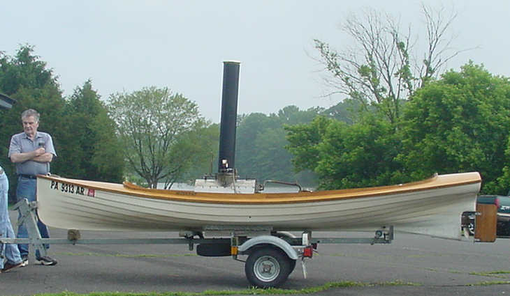

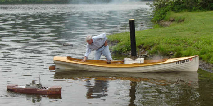

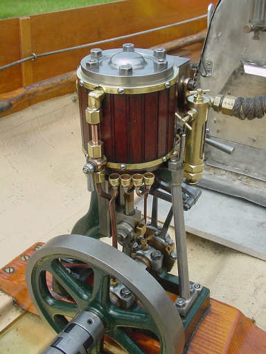

Livingston Morris built this 12 foot steamer with a fiberglass “Wineglass Wherry” hull, Stuart No1 engine, and a wood fired watertube boiler. This boat can easily keep up with all the other steam launches in our group. Judging form the performance of this boat I would think up to 14-16 ft, with light weight construction and a good hull form, 1-2 people boat maximum would be OK for the No. 1 engine.
- Livingston & Muskrat

- Profile on Trailer
- 12ft WherryTrailer.jpg (40.64 KiB) Viewed 13047 times
- Stuart No 1
- 12ft Stuart No1.jpg (30.29 KiB) Viewed 13047 times
