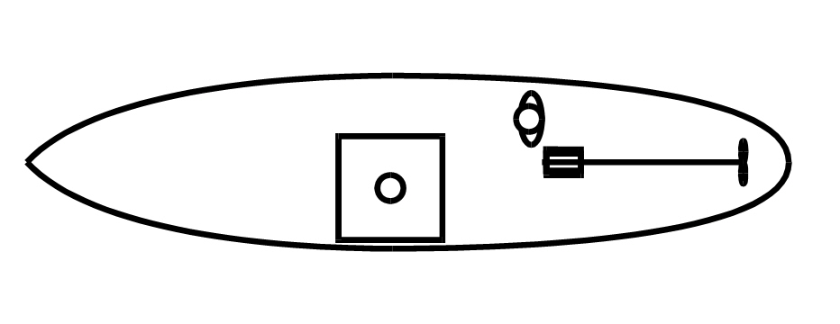

You might want to consider shifting the boiler off-center somewhat. This will allow forward-aft passage somewhat easier with a wide boiler. You and the wood supply would counterbalance this weight shift, to keep the boat on an even keel while underway with only you aboard. Passengers can be placed to keep an even keel as needed, no matter how many are aboard. I see many symmetrical (boiler and engine on centerline) launches that carry a list when only one person is aboard.
- Boiler, Engine, Capitan Layout

Folly lives with a list to Starboard much of the time. I am received of a good deal of snide comments from my friends about my mass on its effect on the athwartships trim. If I build a new hull, I may well consider some non-symmetrical arrangements.
The problem for me is that I and my steering gear and such things are on the Starboard side and if I shift the boiler to Port then it will be even harder for passengers to pass for and aft. No easy solutions.

I hadn't thought of that. My sense of aesthetics demands symmetry, but I also solidly believe in form following function so I am going to give it some thought.fredrosse wrote:You might want to consider shifting the boiler off-center somewhat. This will allow forward-aft passage somewhat easier with a wide boiler. You and the wood supply would counterbalance this weight shift, to keep the boat on an even keel while underway with only you aboard. Passengers can be placed to keep an even keel as needed, no matter how many are aboard. I see many symmetrical (boiler and engine on centerline) launches that carry a list when only one person is aboard.
Great suggestion.
