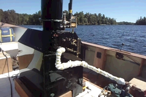

Jon has a large Roberts type watertube boiler, so virtually all of the steam is generated in the tubes running from the two lower drums to the top center water drum. Keeping the gauge glass 1/3 full, or 1/2 full should have virtually no impact on the steam generation rate. As long as there is adequate water in the top drum of the boiler, the steam generation rate will basically depend on the size of the fire, and to a lesser degree on the temperature of feedwater to the boiler.
If you keep up enough feedwater flow to maintain a constant boiler water level, and steam pressure is dropping, then the steam generation rate is lower than the engine's steam consumption rate. Pressure can be kept up by either generating more steam flow with more fire, or reducing engine steam consumption by throttling the engine (or linking up the engine valve gear).
Pre-heating the feedwater will allow an increase in steam generation, roughly 100F increase in feedwater temperature will allow about 10% increase in steam generation rate. This assumes you are pre-heating the feedwater with steam engine exhaust steam.
