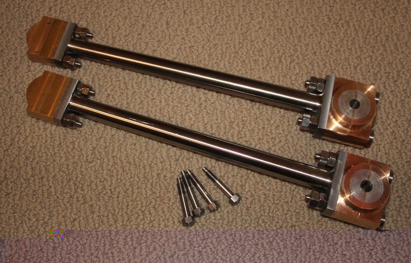

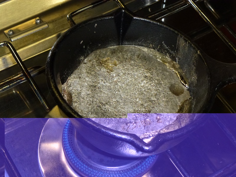

Hello all,
Have had some time to get into the garage to make some more progress on the York engine components and here are some of the fruits of my labor. I had hoped to show more pics of the Babbitt pouring process but it gets a bit hectic and taking photos was quickly forgotten.
- Pot of Babbitt on it's way to being poured
- P1010582.jpg (164.13 KiB) Viewed 115501 times

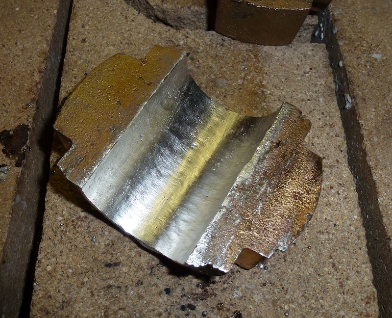

- Tinned lower con-rod casting
- P1010579.jpg (251.12 KiB) Viewed 115501 times
- Con-rods ready to be bored & crosshead bolts
- IMG_2561.jpg (160.46 KiB) Viewed 115501 times

Nice work Ken, did you pour around the shaft, or dip them?

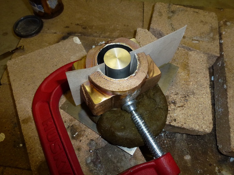

Greg,
My original plan was to pour the bearings with two shells clamped together around a mandrel (center pin and end plate) with the shims in place but I gave up on this after several attempts. It was difficult getting the shelled tinned properly and then getting the hot shells clamped and aligned on the mandrel before they cooled. I kept getting pours that would solidify leaving voids in the Babbitt. I think this was also made more difficult as I hadn't fully machined the castings at this point. I gave up on this method and poured the Babbitt into each shell half with plates clamped over the ends to form a half cylindrical cavity. It was easier to get the end plates clamped on and the shells re-heated without having the Babbitt-rite (damming material) get soft and shift the fixture. I'll see if this method really worked when the lower end bores are machined to mate with the crank. If there are issues with voids in the Babbitt, I think fixturing will be easier now that the lowers are machined. I have attached a photo of the failed setup.
- P1010580.jpg (161.42 KiB) Viewed 115458 times
