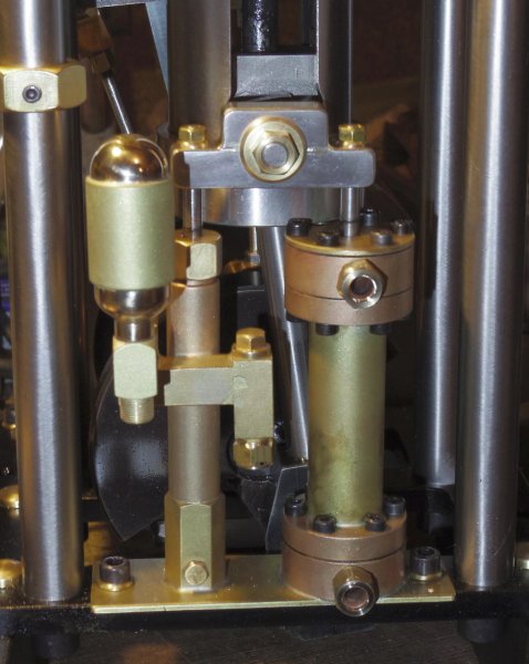

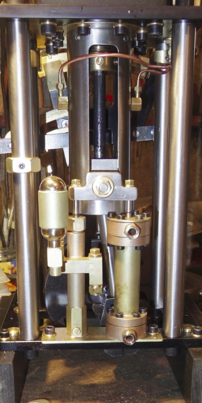

What are the items in the third picture please?

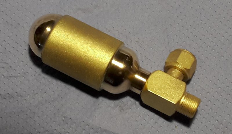

... What are the items in the third picture please?
that is am air chamber. How it works and why it should be used you can find here.
Here some pics of my solution.
A very interesting book answering a lot of your questions is "The stokers manual".

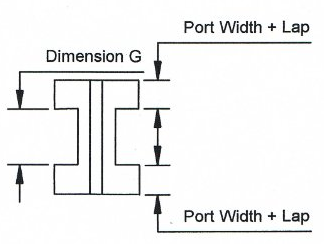

Now comes the difficult part. As the diagram you posted shows, the valve lap is 73 thou on the HP and 102 thou on the LP, can anyone tell me what the valve travel should be in Full Gear and in Mid Gear? The valve gear as built looks to be symmetrical so I suppose the valve travels' will be equal, but as I can't find drawings I don't know if that is correct. All of my valve gear books (6), which are for locomotives, show Joy valve gear with the usual expansion links and not the swinging links that I have. Equally none of these books show me how to lay out the gear with the design criteria needed to establish valve travel.
in full gear - 2x (port width + lap)
in mid gear - should be zero
