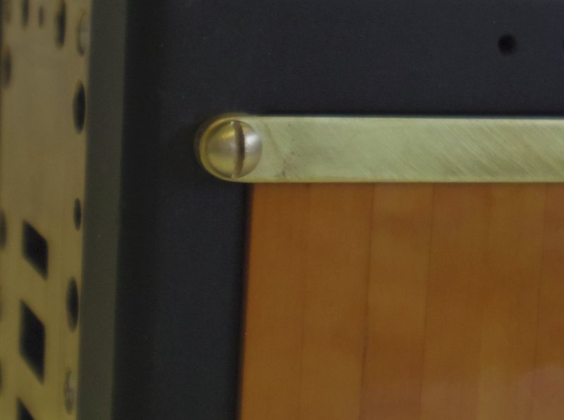

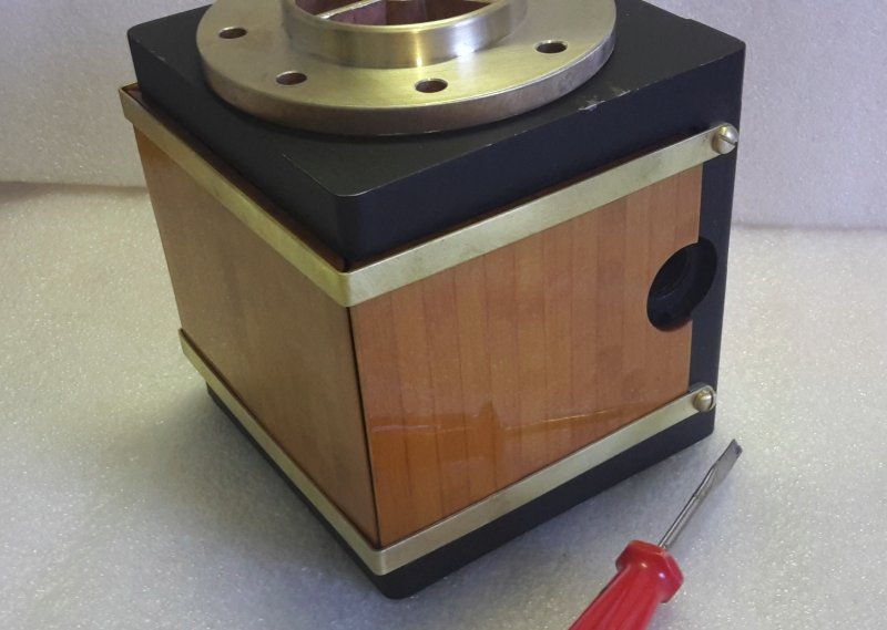

I have used pear and brass. The strips where glued together, sanded and varnished with EPIFANES.
- ZylVerkl038kl.jpg (60.95 KiB) Viewed 20751 times
- ZylVerkl035kl.jpg (33.66 KiB) Viewed 20751 times

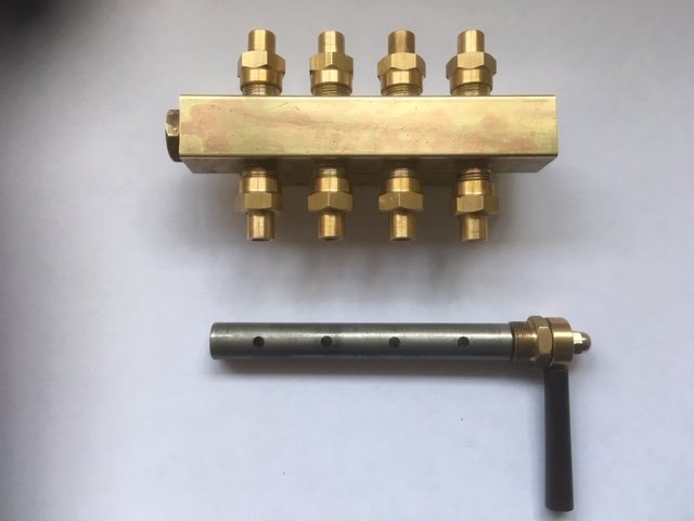

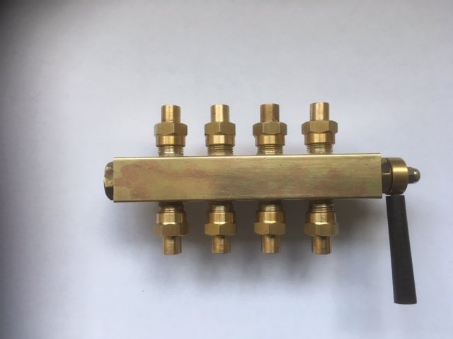

Thank you for the photos and info. As far as the drain cock manifold is concerned here are a couple of photos as it is today. Essentially it is a piece of 7/8" square brass with a 10 mm stainless steel rod through a reamed hole. A bit fiddly to make to get an accurate fit and line everything up. Still left to do is to machine grooves in the stainless between the holes to seal each cylinder from the others with O rings, but I am still waiting for these to arrive.
- Manifold in pieces
- Manifold parts.jpg (28.57 KiB) Viewed 20720 times
- Manifold assembled
- Manifold assembly.jpg (26.56 KiB) Viewed 20720 times

I have similar drain cocks on my Locomotive and haven't found the need for intermediate 'O' rings. The steam oil and condensate is more than enough sealant.
