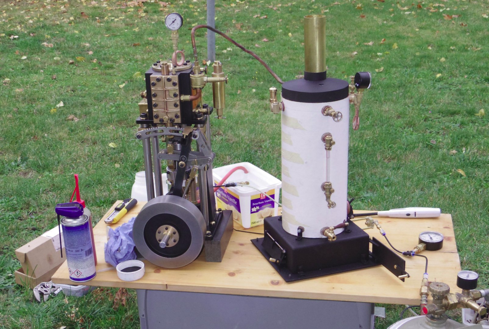

Hello Pete,
a suitable boiler could be such one like my 131350 EICHENDAMPF-VFT.
I have tested it with my HASBROUK10-inspirated single (~ 2 PS).
https://www.youtube.com/watch?v=O9kkZjXPH2Y
A suitable engine could be a 32 x 38 mm single, a 32 + 55 x 38 mm compound or a 32 x 38 TWIN similar to the twin of my steam lorry MARTIN (ex. MODELWORKS "Pride of Penrhyn").

Hi Dietrich & Friends
Thanks for the post & photos, Dietrich. Your boiler the 131350 EICHENDAMPF-VFT. looks just the part. How heavy would it be in operating condition?
Yes I recall your Hasbbrouk engine and the superb modifications that you made to it. I'm not sure that all of us are up to that quality of machine work! However, seeing your steam lorry has given me an idea. What about the idea of a paddle steamer? Your 2 cylinder engine would be ideal, though we might be back to the question of weight again. However, I can imagine removable paddle wheels, and a single board with the engine and axle and then the boiler on a separate board. All could be light enough to lift out and into a car.

Posts: 289
Re: Antidote to Cabin Fever?
Hi Pete,
.... How heavy would it be in operating condition?
~ 20 kg
A paddle wheeler is an interesting option - the engine-boiler-unit could be removable like steam folding boat "CALYPSO".
I think patented paddle wheels are more effectively than the shown. The WESTBURY drawings can easily be enlarged.
