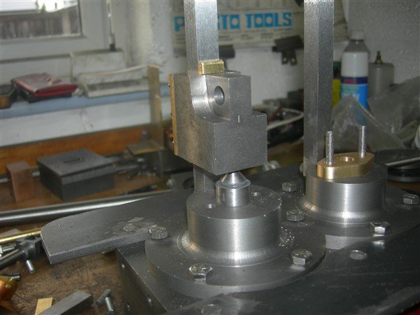

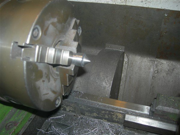

To accurately mark the piston rod centre onto the Cross-head, I use this method.
First produce a centre to fit in the bore of the bottom cover and harden it.
Crossheads (10) (600 x 450).jpg (53.86 KiB) Viewed 34988 times

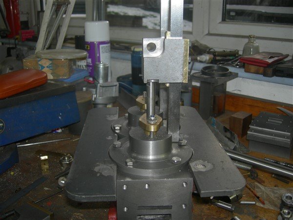

Place in the centre in the bore and slide the Cross-head sharply down on it.
Crossheads (12) (600 x 450).jpg (47.91 KiB) Viewed 34988 times
I was pleased to see my original marking out was exceedingly close.

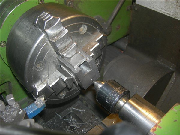

Simple enough to set the Cross-head in the 4-jaw and centre on the pop-mark, checking also that it is sitting square in the jaws with a try-square off the bed.

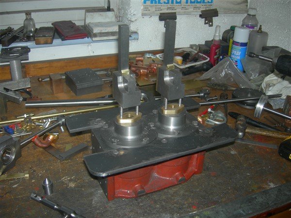

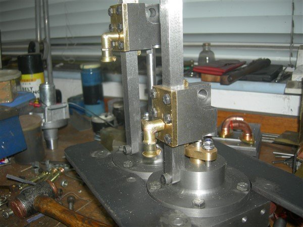

All re-assembled ready now to cut the piston rods to length.

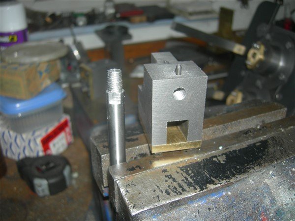

A few bits and pieces have been done under difficulties. To wit, I broke my favourite pair a w/shop specs, and have had to make do with a secondary pair which don't suit close work nearly as well, and I have to wait nearly another fortnight for an Ophthalmologist appointment. This virus has a lot to answer for!!!
Crossheads (19) (600 x 450).jpg (53.98 KiB) Viewed 34847 times

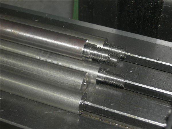

Bearing in mind the comment about rods maybe coming loose and the difficulties of re-tightening them, I added some spanner flats to the piston-rods. They also aid assembly. The woolly thread (pic) had yet to be run with a die to clean up. S/steel (drill rod) doesn't thread well at slow speed (or at high speed sometimes! :? ). I usually don't run as deep as this and give the die a little more work to do. I also added the small grub-screw as a retainer.
Crossheads (20) (600 x 450).jpg (54.46 KiB) Viewed 34847 times

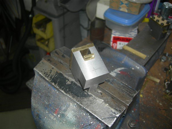

Whilst messing, I added some 'pockets to the Cross-heads for the gland studs/nuts.
So far everything seems right for the 'stroke' except one small item, I think I need to reduce the length of the buttresses on the Cross-head Slippers a touch, just for peace of mind, they don't seem to touch, but are quite close. One must allow a little for expansion!
Only one other comment - it all seems very tight! :o

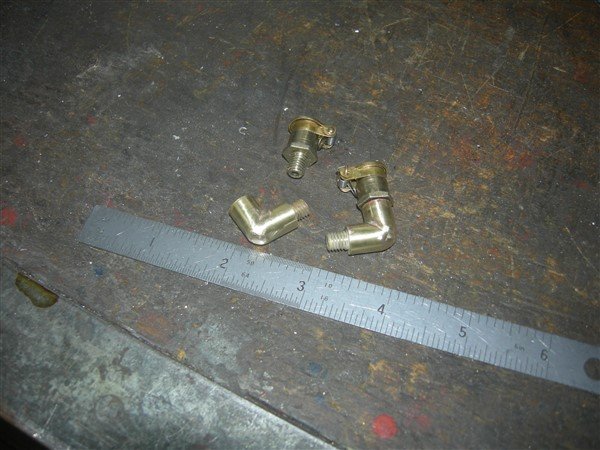

As light relief I made the parts for some right-angle fittings for wick feed oilers to the Cross-Heads. The flip top oilers I usually keep in stock, but they are not wick fed so have to be modified with a riser tube and wick, a simple task when you can see what you are doing (and have three hands!).

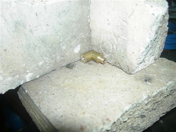

Two pieces silver soldered.
Oilers (5) (600 x 450).jpg (65.68 KiB) Viewed 34729 times
Corners rounded and fitted, backing plates drilled and tapped.
