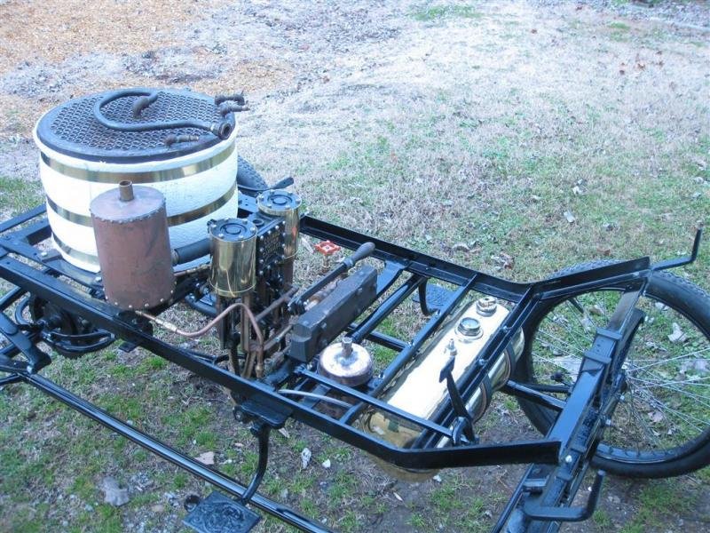

One more tidbit, I have two Whitney designed engines. He designed the little steam carriage engines for Mason regulator, who in turn sold the engines to various carriage builders.

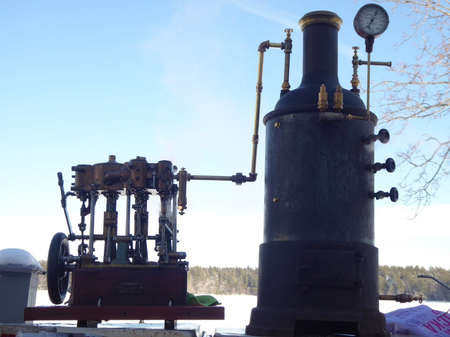

Hi,
amazing. It is a very nice engine. Who built the boiler? What diameter have the fire tubes and what is the distance between them.
Good luck for the further work

dampfspieler wrote: Tue Jan 19, 2021 1:16 am Hi,
Hi Dietrich,
Thank you. The boiler was built here in the US by Bourdon boiler. Very expensive.
The copper tubes are an odd size and there is a story behind that. They are 17/32" or .531" 13.49mm. 1/8" pipe slides right inside the tube. This goes back to George Whitney again, he ran the 1/8" pipe fuel line up one tube across and back down another tube to preheat the fuel to make it easier to vaporize, as 200 psi steam temperature is about perfect to vaporize fuel without cracking it and making carbon. I think most Stanley boilers still use that size tube but they don't route the fuel line like that anymore. That is where that odd size came from. It's like George Stephenson started using 4' 8-1/2" gauge for his railroad and it was never really changed. He copied the width off of a coal wagon in Manchester, and to this day it's still the worldwide standard. Isambard Brunel tried with a 7 foot gauge on his Great Western Railway but there was too much track already laid around the rest of the country to replace all of it, so the 7 foot gauge was dropped.
I will measure the distance between the tubes and let you know.
