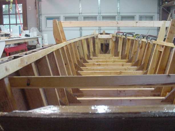

Great job, sure you will enjoy this boat very well. Just for some inspiration, or should I say perspiration, here is the state of the Margaret S, just 5 days before the last steamboat meet of the season (2010). We got the hull finished (without deck), boiler, burners, engine, paddlewheels, their shafts and bearings, piping and feed pumps installed, all steaming and attended the meet.

Looks great Mike! That layup method prior to cutting and building is an awesome method. I don't know why that isn't taught more. Did you have any flexibility issues with the sheets post-layup?
- Posts: 1928
Re: Building Spiffy
Not really. We did install temporary struts to hold the first set of sheets at the correct distance apart. When we added the sides it got a lot stiffer and as soon as the bulkheads were glassed in you could have dropped in the engineering plant and gone steaming. The decks made the boat into a very stiff structure.
Adding the box keel later saved us a lot of work. And added a lot more beam stiffness. Right now I can set the hull on one 2 x 4 board like a teeter totter in the shop and walk around in the hull with no creaking.
It's not that cheap. I spent $5K on plywood, glass and resin and other things to get a floating hull. And I'm spending more now. Priced Honduran Mahogany lately? I'm going to drop $200-300 on the coaming alone. Ask Steve for more horror stories. A used boat is a bargain most of the time.
The bare hull when I paused two years ago weighed around 800 lbs. I will likely sneak in under a ton due the small engine and only 400 lb. VFT boiler.
