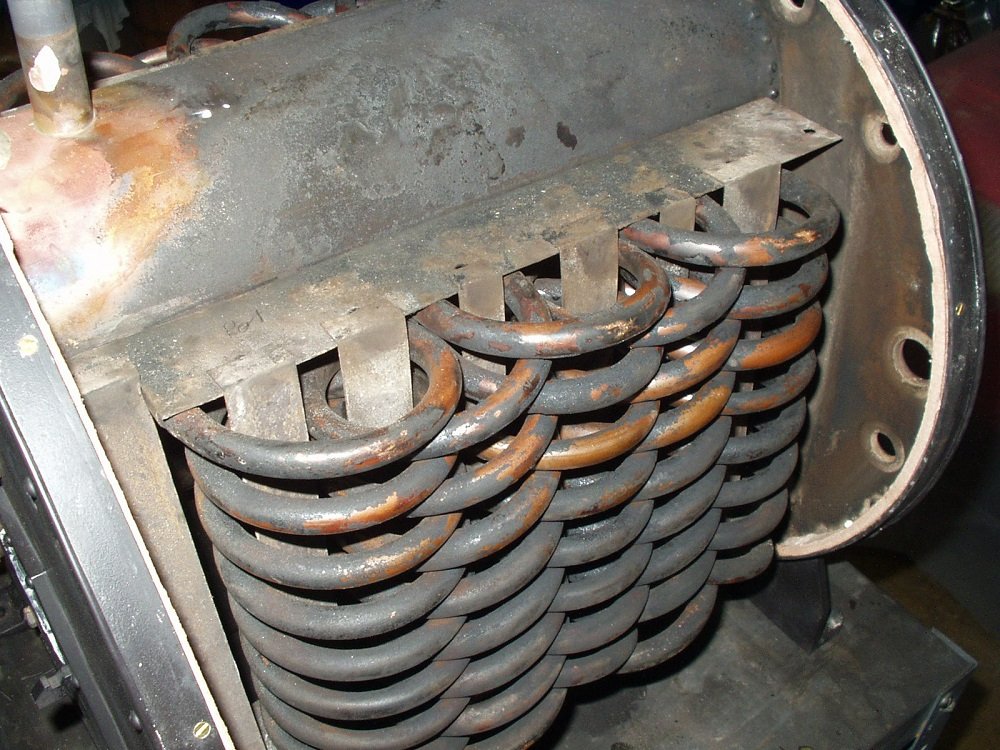

I believe that a lot of your problem can be traced to the coils being too "open", i.e., there is too easy of a path from the source of the fire to past the coils, so a lot of the heat is passing them by without transferring. I had the same issue with my solid fueled Blackstaffe boiler. Initially, the bottom 2/3 of the coils didn't even have any soot on them.
I installed baffles from sheet steel across the top of the coils and hanging down between them, so the heat had to pass within close proximity to them on its way to the stack.
A temperature gauge on the stack is a worthwhile investment. Mine dropped by hundreds of degrees by adding the baffles, so all that heat was then going into the water.

Also, I bend my economizer tube in a squared off coil around the top and outside of the coils to scavenge as much remaining heat as possible from the boiler, downstream of its coils.

The old casing had a bad case of tin worm and needed complete replacement. When I disassembled it I took my usual precaution of photographing each stage and your post sent me back to that record. I checked and there was no sign of a baffle across the top of the coils BUT then I saw a single photo I had missed and, sure enough, there WAS a baffle and I had not incorporated it into the new casing! That explains a lot and I am very grateful to you for pointing it out. It's an easy enough mod to make and it is now on the job list for the winter along with the downcomer insulation.
One query in respect of the perpendicular strips hanging from the horizontal baffle: its difficult to make out but is there a twist in those to promote a swirl?

Old Steamer wrote: Tue Aug 22, 2023 7:43 amOne query in respect of the perpendicular strips hanging from the horizontal baffle: its difficult to make out but is there a twist in those to promote a swirl?
No twist, they are just straight when hanging down. At their top ends, they have a small tab pointing down that fits into holes in the top, horizontal strip. See the far end of that strip in my second photo for the hole. The hanging strip wasn't fitted there yet.

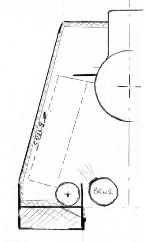

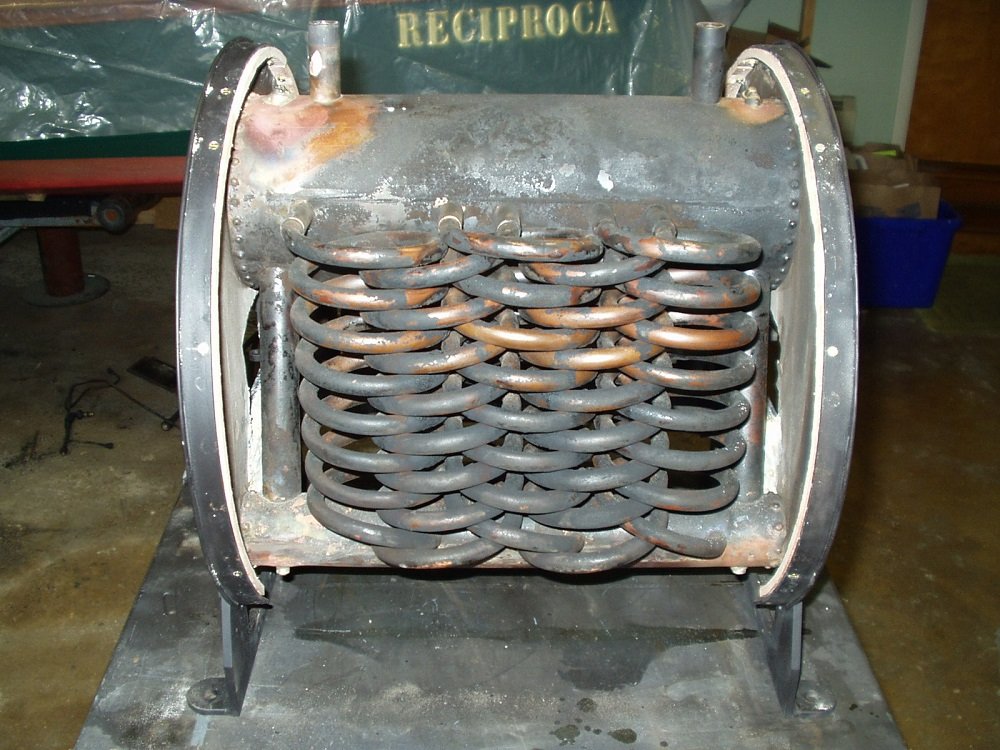

OK Gents, I am with you in respect of the baffles although I'm not sure how Kelly's perpendiculars function but then maybe I am just being dim. If I replace the missing baffles over the tubes exits to increase the flue gas dwell time in the casing and consider if I can fit some other form of baffling where possible, then I reckon that is about the limit. (Plus ensuring the downcomers operate as such.) A rough sketch of the result is attached.

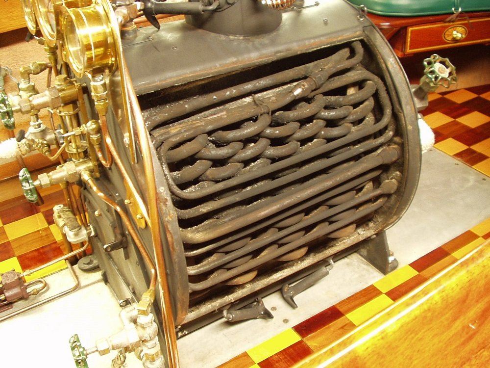

Out of interest, I have also attached a shot of Woodbine's boiler taken some 20 years ago although I understand she is still operating in France. A smaller Blackstaffe than mine but a very similar layout.

Ignore the last line of that posting. I'm still struggling to post photos.
This is Woodbine's boiler.

thank you for the picture. The flames are really close to the watertubes.

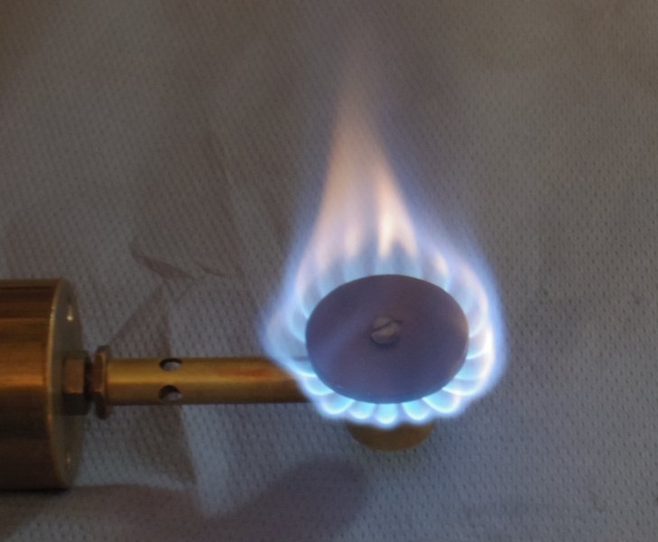

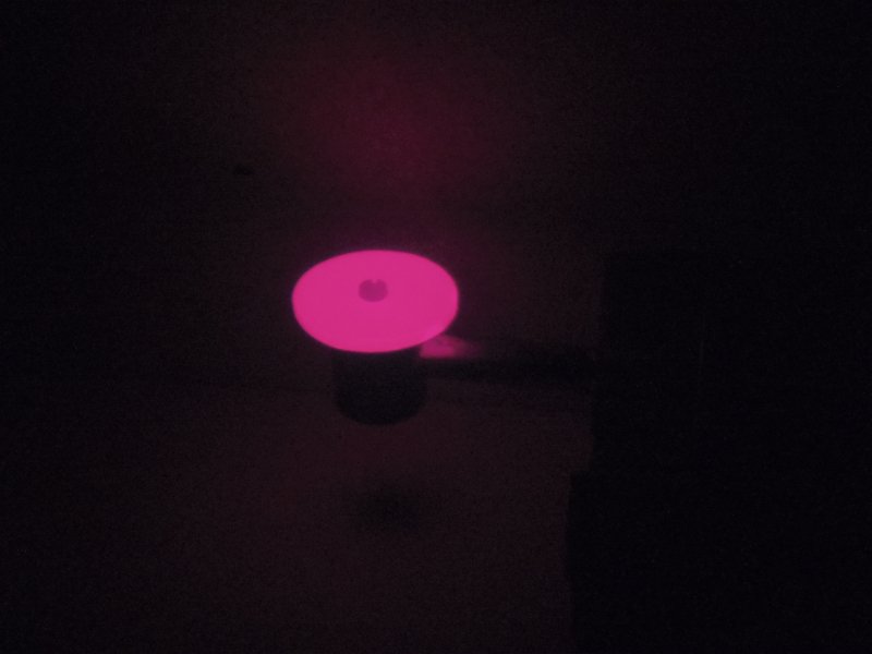

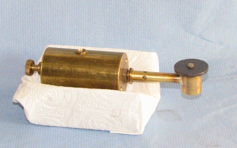

I have refitted some years ago a little gas burner for a KRICK steam engine with a "cover plate" to improve the Heat transfer to the boiler and to protect the flame from blowing out.
The cover plate was made from 3 mm copper sheet. Its temperature was about 750 °C.
The video of the test - https://youtu.be/ee_S-Aj-BGo?si=hXyolv2cjjS_6-eU
The owner of the little ship was very happy. It might be a useful addition to your gas burners.

Old Steamer said: "I'm not sure how Kelly's perpendiculars function"
I believe the vertical extensions from the top baffles act as additional barriers preventing the heat from quickly escaping the tube area.
They force the heat around and through the tube bundles, providing opportunity for additional heat transfer to the water tubes.

Don't read too much into my sketch which is not to scale; the scope for moving the burners further inboard is quite limited. The advice I had from the owner of Woodbine was to rotate the bar burners such that they were directed at the coils without flame impingement. I followed his advice and there is no flame impingement in my boiler.
I will try Kelly's perpendicular baffles but, where possible, give them a twist to create a swirl and slow down the flue gases.
I have toyed with the idea of some form of baffling on the fireside of the coils but Woodbine didn't need it (see photo) and neither did Volcania which had a similar size of Blackstaffe. I think it would be a lot of trouble for negligible gain.
