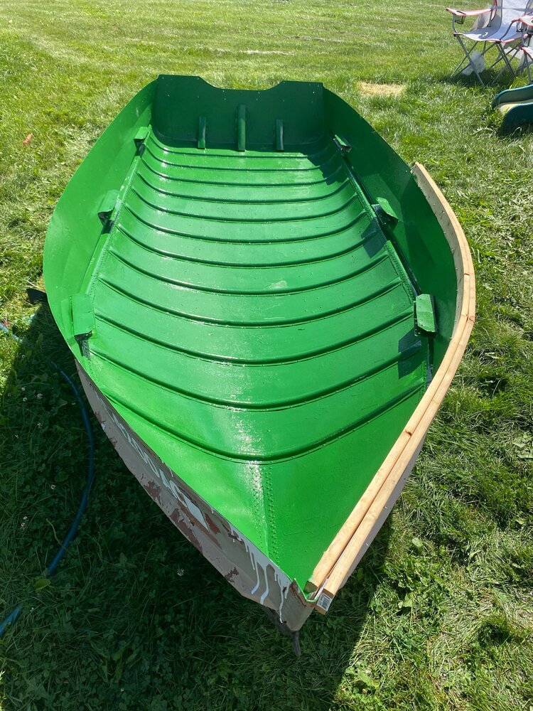

I've now got the engine and the boiler to the point where I need to start working on the boat itself. The intended hull is a small old 14ft aluminum v-hull fishing boat. Last year my FIL gave us his old 14ft aluminum v-hull. All the wood was rotted, and normally it would've been easier to ditch this boat and find a more shapely one in better shape, but this boat has a big advantage many of you will understand:
This is my wife's childhood fishing boat, so she has a lot of nostalgia attached to it. This translates to significant leeway in time and budget to get it back on the water.
So far I've stripped all the rotting wood off, wire wheeled all the paint loose enough to come off on the inside, then primed and painted the inside.

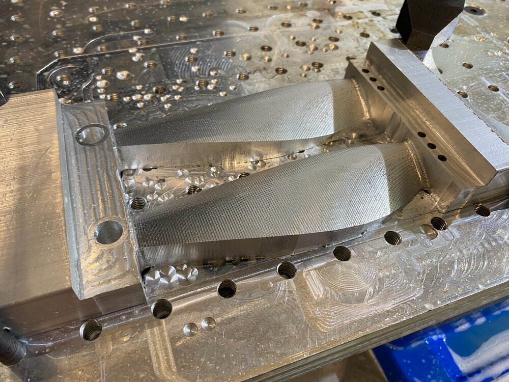

In the meantime, I was bored at work last week and starting thinking about the propeller. I don't want a paddle wheel, as they are big and bulky, and it's a lot of fab work compared to the mostly machining work of a propeller and stern tube. I looked at APC propellers, but didn't really see anything that wouldn't be a compromise. So I ended up deciding to make my own propeller to save $25have the pitch and size I needed. I found a propeller cad model generator online and created a 12in x 20in propeller, targeting 5mph at 300rpm.
It was a huge pain (and took about 5 hours of machine time per blade!) but in the end it turned out well.
After rounding the ends and sanding smooth, it turned out pretty good. I put it on a cordless drill and stuck it in a kiddie pool and it generated significant thrust. I don't like the hub so I think I'm going to 3d print a more hydrodynamic shroud for it.
