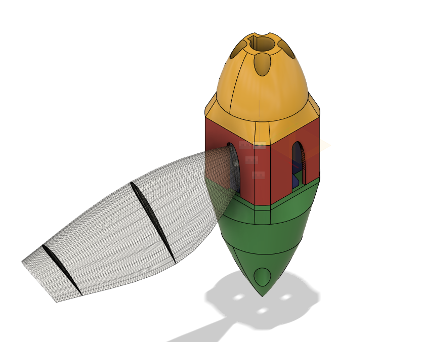

So far I've stripped all the rotting wood off, wire wheeled all the paint loose enough to come off on the inside, then primed and painted the inside. In the meantime, I was bored at work last week and starting thinking about the propeller. I don't want a paddle wheel, as they are big and bulky, and it's a lot of fab work compared to the mostly machining work of a propeller and stern tube. I looked at APC propellers, but didn't really see anything that wouldn't be a compromise. So I ended up deciding to make my own propeller to save $25have the pitch and size I needed. I found a propeller cad model generator online and created a 12in x 20in propeller, targeting 5mph at 300rpm.
It was a huge pain (and took about 5 hours of machine time per blade!) but in the end it turned out well. After rounding the ends and sanding smooth, it turned out pretty good. I put it on a cordless drill and stuck it in a kiddie pool and it generated significant thrust. I don't like the hub so I think I'm going to 3d print a more hydrodynamic shroud for it.

In the meantime I've got pretty much all the wood sealed and ready to get put on the hull. A local farm store sells stainless steel bolts by the pound, so I have to pick up a bunch of those next paycheck. In the meantime I ordered 12mm stainless steel rod, a flexible coupler, and mechanical shaft seals for building the stern tube.
I machined two more blades, and I'm working on the stern tube and hub and such. The stern tube uses a 3d printed bearing, and a standard mechanical shaft seal.
