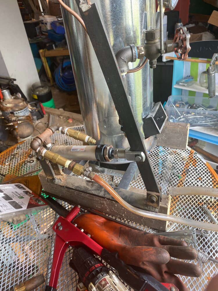

My hand pump is very crude looking, but very cheap and easy. It's literally an industrial pneumatic cylinder, and a couple pneumatic check valves. Most industrial air cylinders are good to 150-200psi, and are aluminum and stainless steel. They can be had for a pittance on Amazon or wherever. Just pay attention to the thread size on the smaller ones.

Many thanks for posting the suggestion and the photo. What an excellent idea! I notice that the cylinders are widely available on eBay on this side of the world so there is every chance I will copy you. I just need the time to get a drawing done...

Yes, the cylinder is off the shelf (chinese) pneumatic cylinder from amazon. I work with these cylinders every day, they usually have viton o-rings and either stainless steel or chromed piston rods. The only thing the look out for is that the ports are often BSP instead of NPT.
The steel parts are literally from an old bed frame, no designs, all eyeballed, angle grinder and cheap welder.
I wish I knew where I got those check valves, because they are really nice. As long as you're not working with hot water or steam, many off the shelf check valves will work. Sometimes you have to watch for the cracking pressure on the "suck side" of a pump. For steam rated check valves, I bought some all bronze gravity swing check valves from Menards. They worked great in my WIP lamont boiler. The only problem is they don't come in anything smaller than 1/2" npt.

I am at the moment building two versions using these cylinders since I accidentally bought a pair. If anybody is interested in my designs I could post them up here. One is a classic vertcal type based on the pump that I had in Frances Ann, while the other is a development (rip off?) of the design in Rolph's picture.
