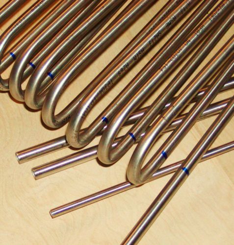

The ASME Boiler & Pressure Vessel Code prohibits the use of "Austenitic Stainless Steels" for wetted parts of the boiler. This includes the 200 Series and 300 Series Stainless Steels. The most common stainless steels encountered are Types 304 and 316, probably 90+ % of the stainless steel used is 304 or 316, and they are prohibited for use in the wetted parts of the boiler. Other common grades: 201,203, 301,302, 303, 304L, 305, 308 (weld wire), 309, 316L, 317, 321, 347.
These stainless steels however are commonly used as tubing in various liquid heat exchangers, fluid system tubing, instrument tubing, etc. They are legal for the "non-wetted" parts of a boiler, such as superheater tubing.
304/304L tubing
304/304L tubing
ss tube .jpg (57.34 KiB) Viewed 5023 times
