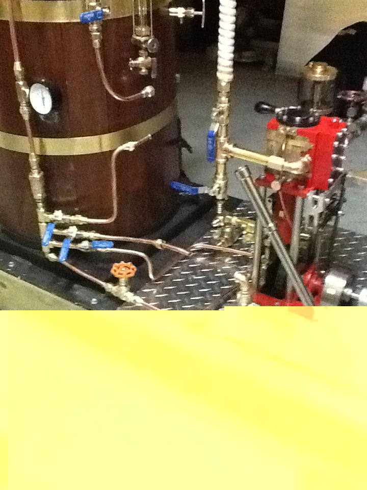

I tried my bypass tonight and it seems to work. I sort of made a manifold which all three pumps connect to each having its own isolation valve. The bypass is also on the manifold and when open slightly reduces flow of water. The bottom valve is the feed pump, the middle is the hand pump, and the top is the steam injector, still lots to do but with a little description i think you can see what i'm doing. The bottom gate valve is my bypass valve it goes back to the feed pump. The supply line goes up through the check valve to the top of the boiler, around a coil for feed water heater and down the other side through a valve and in the bottom of the boiler.
If all this works ok my next challenge is a neat and tidy way to supply all these pumps with a check valve before each. I got frustrated tonight so packed it in tonight. I'm thinking my one main supply1/2" from the seacock through a strainer then another "manifold" feeding three 3/8" flapper type checks.
What do you guys think?
