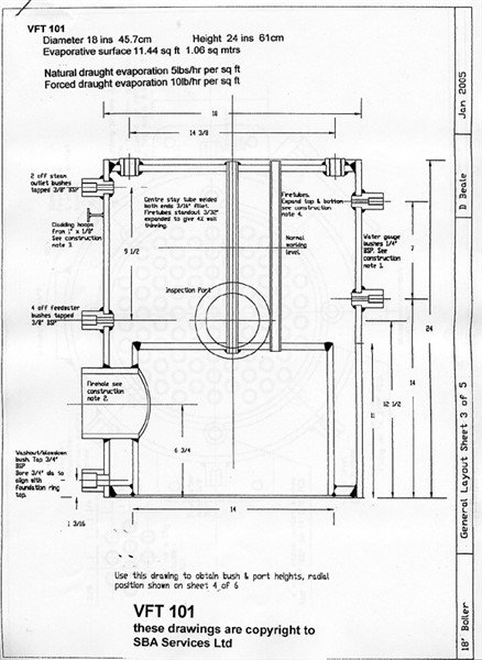

The SBA design looks very nice with a water leg around the grate. I am posting it here as I thought it might be appreciated.

Second picture to follow.

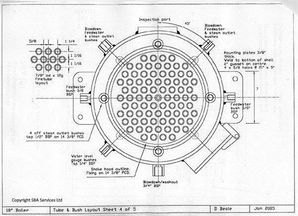

Herewith the plan drawing:

Please note these drawings are the copyright and property of SBA Services ltd.
Jack
(Director SBA Services ltd)

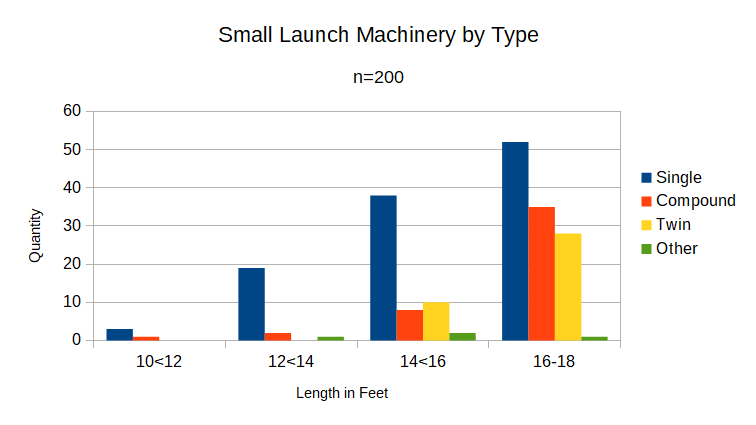

Just been doing a little more playing about with the SBA Steamboat register extract. This gives us some idea of the technology adopted by boat owners in the size category about which this thread has been discussing. Interesting to see that some quite small boats have gone for compounds and that the more steam hungry twins expand as the boats get larger. Is that because there is more room for a bigger boiler?

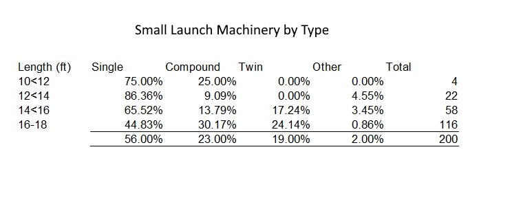

For those who prefer the data as numbers, albeit processed here is the table:

PeteThePen1 wrote: Sun Jun 21, 2020 9:59 am Just been doing a little more playing about with the SBA Steamboat register extract. This gives us some idea of the technology adopted by boat owners in the size category about which this thread has been discussing. Interesting to see that some quite small boats have gone for compounds and that the more steam hungry twins expand as the boats get larger. Is that because there is more room for a bigger boiler?
What type of engines make up the "other" category? Triple expansion and turbines?

Oh My! You chaps keep me on my toes!
The 'Others' that I did not feel fitted in with the rest were:
Oscillating single
Quadruple Expansion
Single Uniflow
Horizontal Single

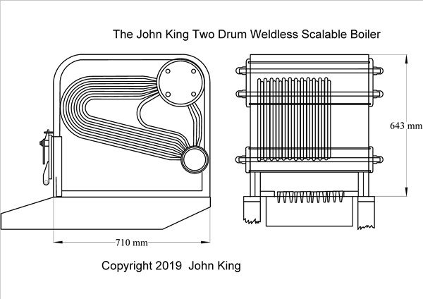

I think that a possible 'new entrant' boiler of simple(ish) construction that involves no welding is now available as a design for home construction.
SBA member John King has explained that his two drum boiler has been designed to make construction straight forward. For example the drums are sufficiently large to allow a Wickstead tube expander to be used with a right angle drive and power drill. The design has also been approved for expansion in the number of tubes so that the output can be matched to the chosen engine. It is also possible to mount the drum across the boat or along the length of the boat. The latter provides a better position for the water gauge although the design package includes a rather nice reflex gauge designed for a horizontal set up. The design uses Cunifer 10 for the tubes and Viton O rings for sealing. The design pressure is 250 psi.
A sketch of the boiler is given below:

Full details are available from John King. SBA Members can look him up in the Members List while non-SBA members are welcome to send me a PM and I will pass on your request. I do not know the cost of a licence for the design.

That's a very interesting design. This coming from a VFT devotee!
One thing that would concern me would be how to make sure that the tubes were still round where they meet the drums. It's not that far from the tube/drum connection to the first bend. Maybe a temporary mandrel in the end of the tube that is removed after the bending? I am sadly ignorant of bending techniques and limitations.
