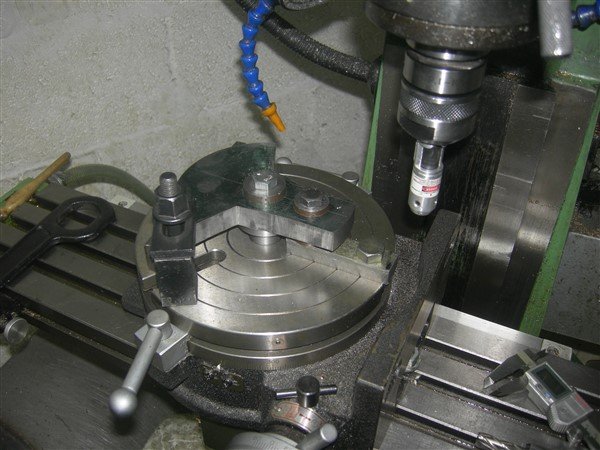

Too late now to change my mind. The bulk has been removed with the band-saw and the set up and method tried by giving a dry run-through using the laser centre/edge finder for the tool. It works! (or seems to!)
Crank Webs (14) (600 x 450).jpg (64.8 KiB) Viewed 30470 times
Set up ready to go when some new cutters arrive.

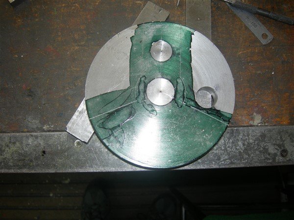

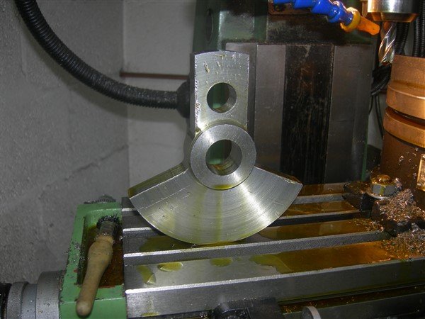

One is now done!
Crank Webs (17) (600 x 450).jpg (55.73 KiB) Viewed 30435 times

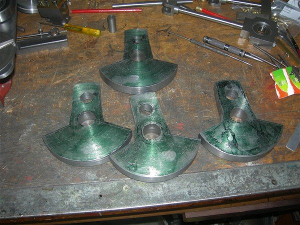

Further to Dietrich's idea, I think in the vice, the curve for the boss would be difficult with a fly-cutter, meaning they would probably need to go on the Rotary table anyway for finishing off. The raised bosses would also make them difficult to grip well. I cut this one (very carefully) in just short of half an hour, so not too bad. The slowest part was picking up the end of the boss curve to cut the weight edge (and remembering which way to wind the R/table! :roll: ).

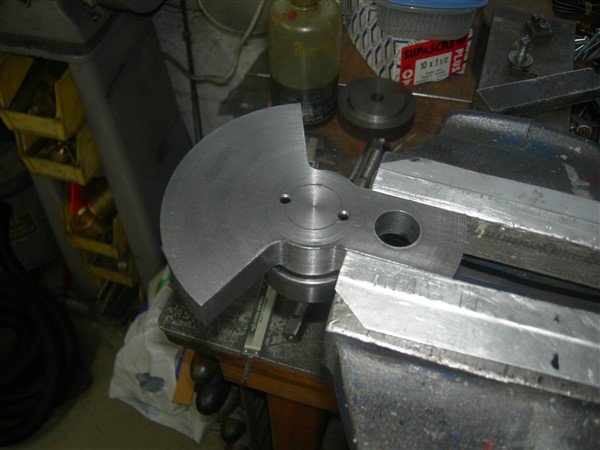

To that end the first section has been pressed together, drive end and first web.
Crankshaft (20) (600 x 450).jpg (66.79 KiB) Viewed 30321 times

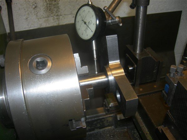

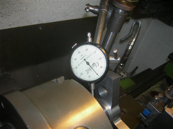

I fitted my best 3-jaw to the lathe and with and small addition (see pic) to the D.T.I. to clear the throw and weight, checked out this first piece.
Crankshaft (21) (600 x 450).jpg (44.76 KiB) Viewed 30321 times
The next stage will be to press in the crank-pin and then drill, tap and screw in 16mm long grub-screws to lock the parts together, any other order would leave me unable to access one of the faces for drilling and tapping. Before then I checked out the run of the shaft. No chuck is perfectly true so it is important when truing a crank to know where you stand at the start. See next post.

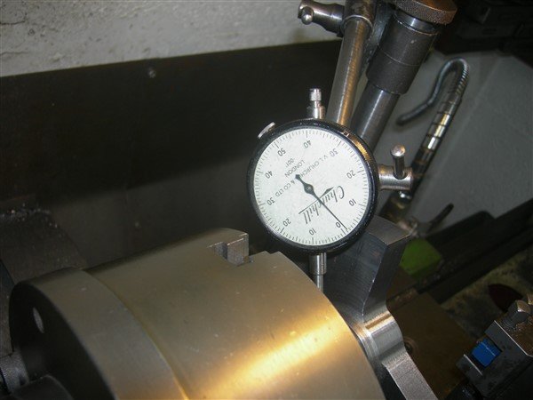

Set the D.T.I to zero at Jaw No 1
Crankshaft (22) (600 x 450).jpg (41.05 KiB) Viewed 30320 times
Rotate by hand and check the run-out as you turn. Mine is worst on N0 2 jaw, note 0.0015". This will be checked again at each intermediate stage as the chuck may not settle at exactly the same reading next time. The run-out here will need to be equal (as near as possible) on the centre section and the tail. I will also always re-set with the 'throw' on Jaw 1.The run-out on the face of the web is just 0.001". I'll live! :lol:

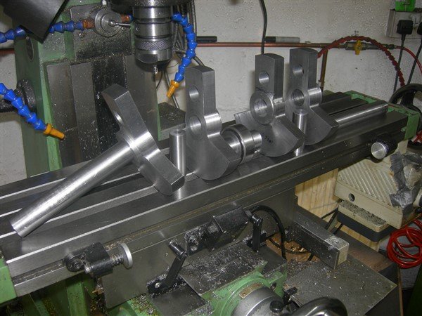

All the parts awaiting final fettle before assembly.
Crankshaft (24) (600 x 450).jpg (70.25 KiB) Viewed 30320 times

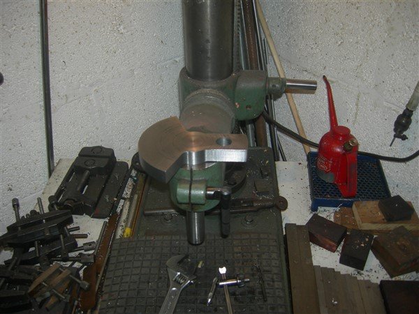

Thanks Russ, I'd like to say it's all plain sailing (pun), but I had a hiccough this afternoon. I was drilling and tapping some of the screw-keys. I think it might have been Fred, on here, who called them "Po' boy keys". Very apt!

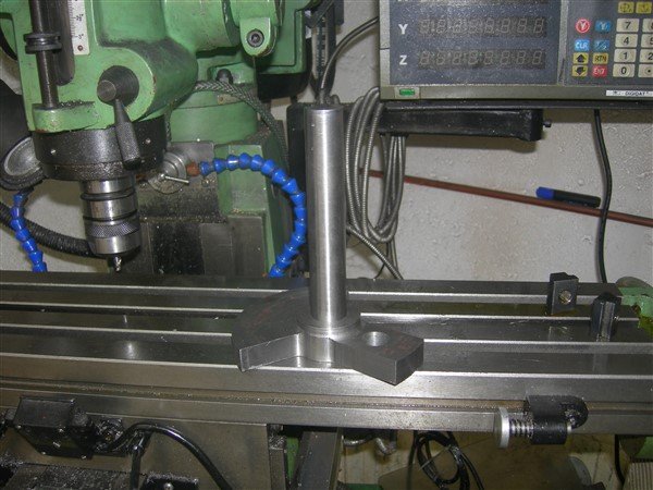

Crankshaft (26) (600 x 450).jpg (48.82 KiB) Viewed 30282 times
and suddenly found that the shaft wouldn't pass in the hole through the centre of the drill table. I think they call that an "O. S." moment. I could get it in the mill but couldn't support it accurately, so had to remove the drill table and make a collar for the support arm. Caused a little head scratching for a few minutes.
Crankshaft (27) (600 x 450).jpg (64.7 KiB) Viewed 30282 times
When I fit these I try not to use lube on the taps and never use a bottom (plug) tap, only seconds. My theory is that they grip better as the last bit of thread gets tighter which really grips the grub-screw. I also fill the hole with Loctite and hope the screw forces it into places it didn't know it had.
