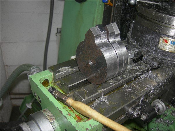

10mm M.S. plate, four pieces. In some ways I would have preferred brass but 10mm is NOT cheap, and it wasn't in stock! I thought about Dietrich, and doing them in one hit, but discretion said, do it in two. I don't trust the stiffness of the mill with such a long cutter. Just call me windy! :D

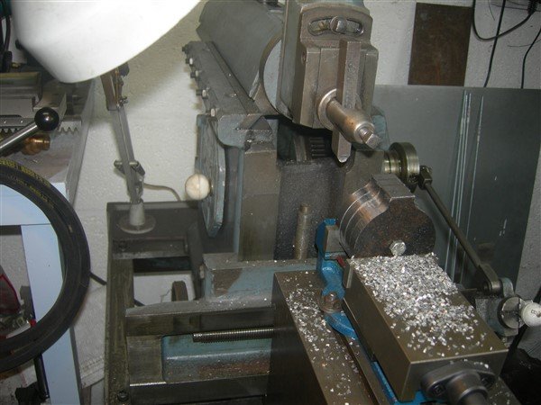

I don't know how many of you will still be using one of these. I do, and love it. It is so versatile. Set up, switch on and leave it whilst getting on with something else, in this case on the lathe. When the note changes, just add a cut, change the direction, and return to what you were doing, seconds later. It doesn't remove metal that quickly, just in big chunks each stroke, it can also gives an excellent finish with light cuts.

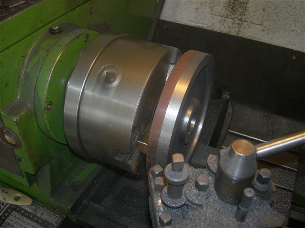

To set up in the chuck I use the small piece of pipe laying on the cross-slide, as a spacer, that gives me a grip of about 3mm (1/8") but ensures a true setting. These will be bored and counter-bored on this same setting, before reversing to clean off the back. Why do them with the internal jaws? Just to make sure I have clearance from the jaws when passing through the bore.

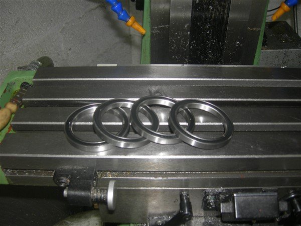

All four completed and bearings fitted. There was a little bit of a faux pas with the last one I took out a couple too many tenths and the bearing isn't as tight as I would like. Easy sort for the job, not so easy for my pride, I thought I was doing so well!

I ran shapers off and on for a long time, a 16,22 and 24 inch hydraulic. Great for roughing out forming dies. If ya take one of them chips down the shirt collar first thing Monday morning, it'll get ya right for the whole week. :lol:
We always put the vise end towards the wall for that reason.
I had a 16" Cincinnati in my shop for many years and finally got rid of it as it wasn't used much after we got a few CNC mills. Sold it on Ebay, some yokel showed up from 700 miles away to pick it up with a dual axle trailer, we set it on there and the bed sank all the way to the axles. He made it home surprisingly.
Ron
Re: And Now for the Twin
That's just a baby Ron, only 8" Boxford, but a little cracker!
You still have to watch out for the chips though. :lol:

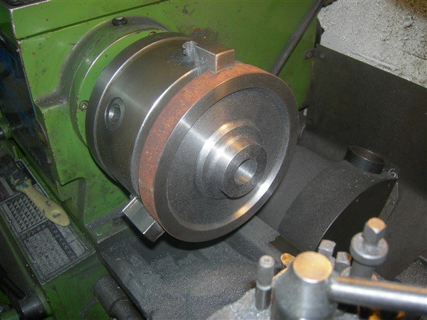

This is my method of cutting an internal keyway, I never seem to need to cut many so it's simple and still reasonably quick, and saves the cost of broaches. Grind a tool to the correct width and with a cutting face. Lock the chuck. Set the tool on centre height and adding a few thou at a time push it through the bore with the saddle, til you have the right depth (measure with a vernier).

Turn it round and do the other side. The rim is 0.875" Ish wide and the recesses are about 0.250", so still plenty on the web.

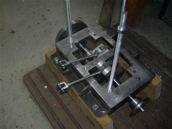

I have done a little to the twin, made a few studs and the like, and it has now had a trail assembly to check clearances and adjust for the optimum pillar length.
Trial Assembly (2) (600 x 450).jpg (57.32 KiB) Viewed 67932 times
The crank feels very smooth when rotated by the rods. The cylinders are very tight and I may take a couple of thou off the pistons if I decide that is the cause. Small clearances are good, but too tight is as bad as too loose. No rings are yet fitted.
