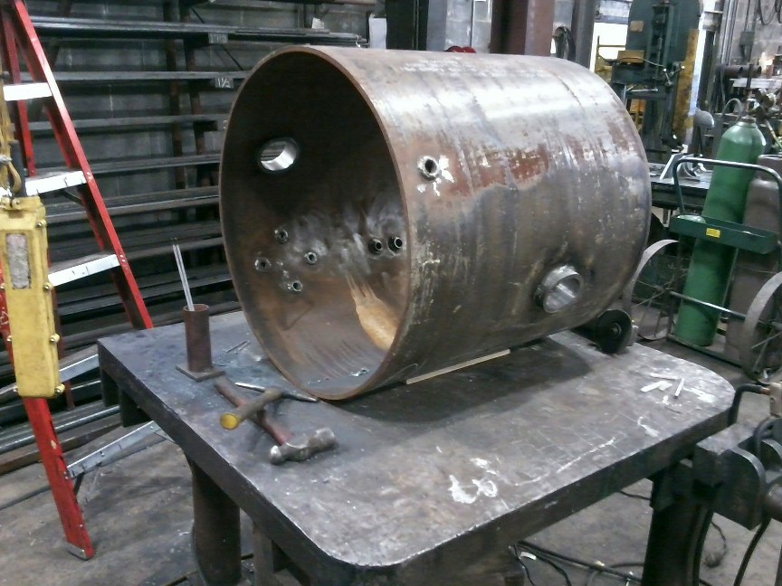

Weld-a-palooza! In addition to welding on my own boiler today (see thread and link above), Mr. Anderson and I fit up and tack out two Mike Condax-designed boilers for Mr. Anderson and Scott Lefever. A fine way to spend a Spring day! These will all be code boilers. I apologize for the quality of the photos - camera phone.

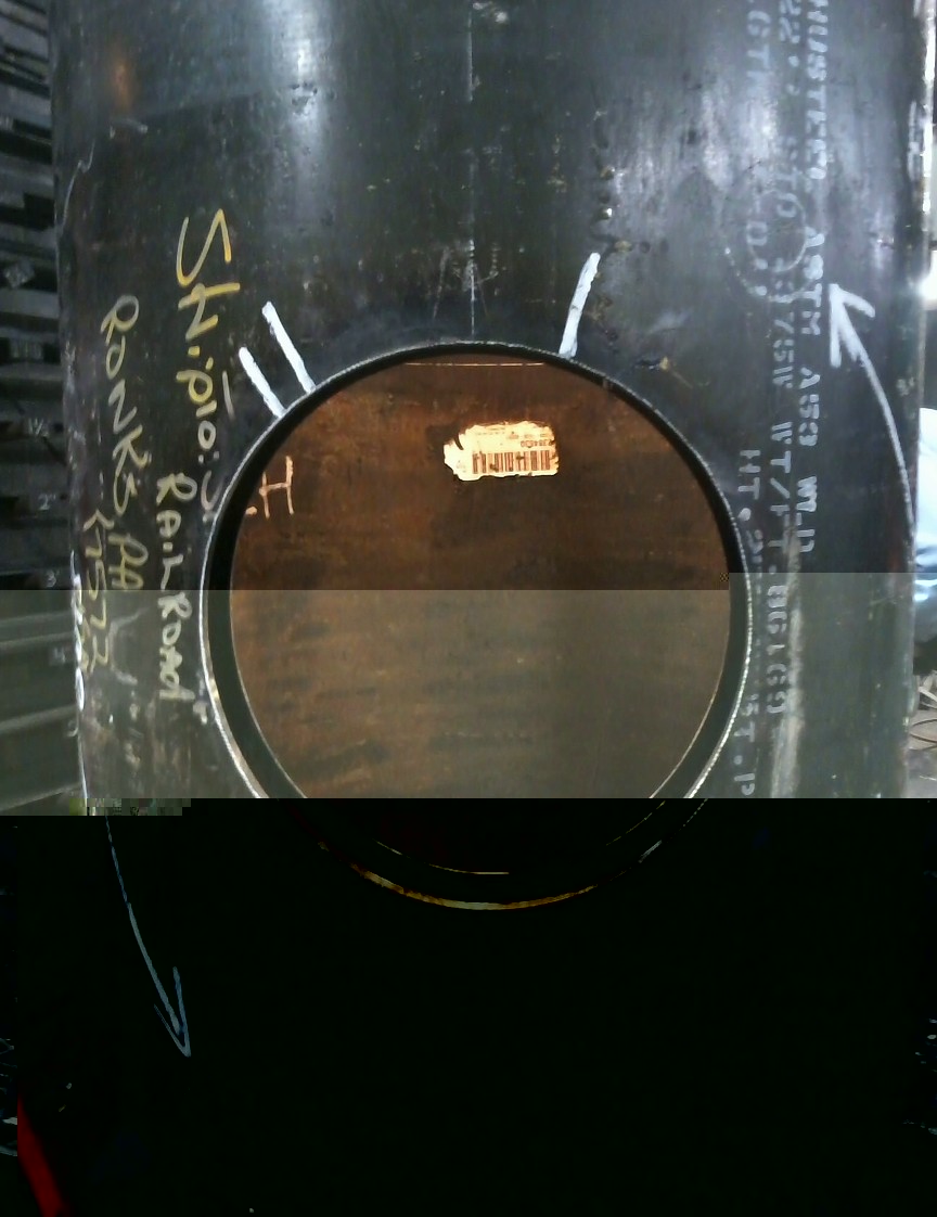

Here's some fire door detail on Mr. Anderson's boiler prior to tacking the door piece. One can see the firebox inside.

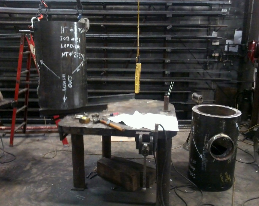

Here's the grab of mine that I posted on the blog http://steamlaunchiona.blogspot.com/

Re: Three's a Crowd
Welding, welding, welding, that seems to be the thing this spring in PA. Is that welding table in your pictures made from a piece of plate?? Bet that is not too easy to move around, unless you have an overhead gantry crane.

fredrosse wrote:Welding, welding, welding, that seems to be the thing this spring in PA. Is that welding table in your pictures made from a piece of plate?? Bet that is not too easy to move around, unless you have an overhead gantry crane.
Yeah, Fred, it's no Acorn. The ten-ton overheads shift it around for us ...
