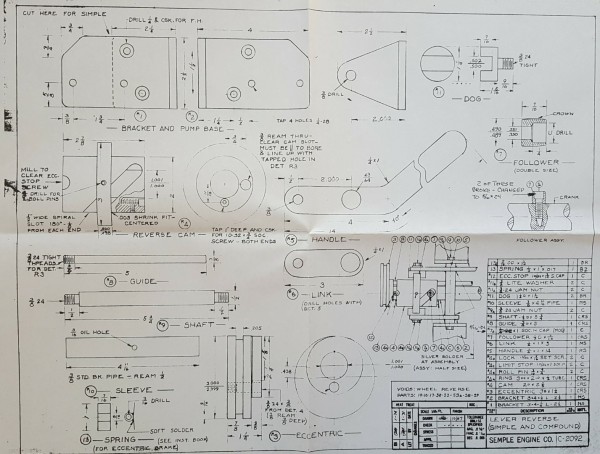

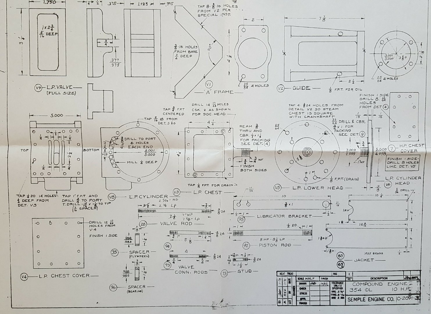

I have .jpegs of the drawings of the V compound.
I will try to post the ones that may help.
Wayne Breidford
SL Windrush

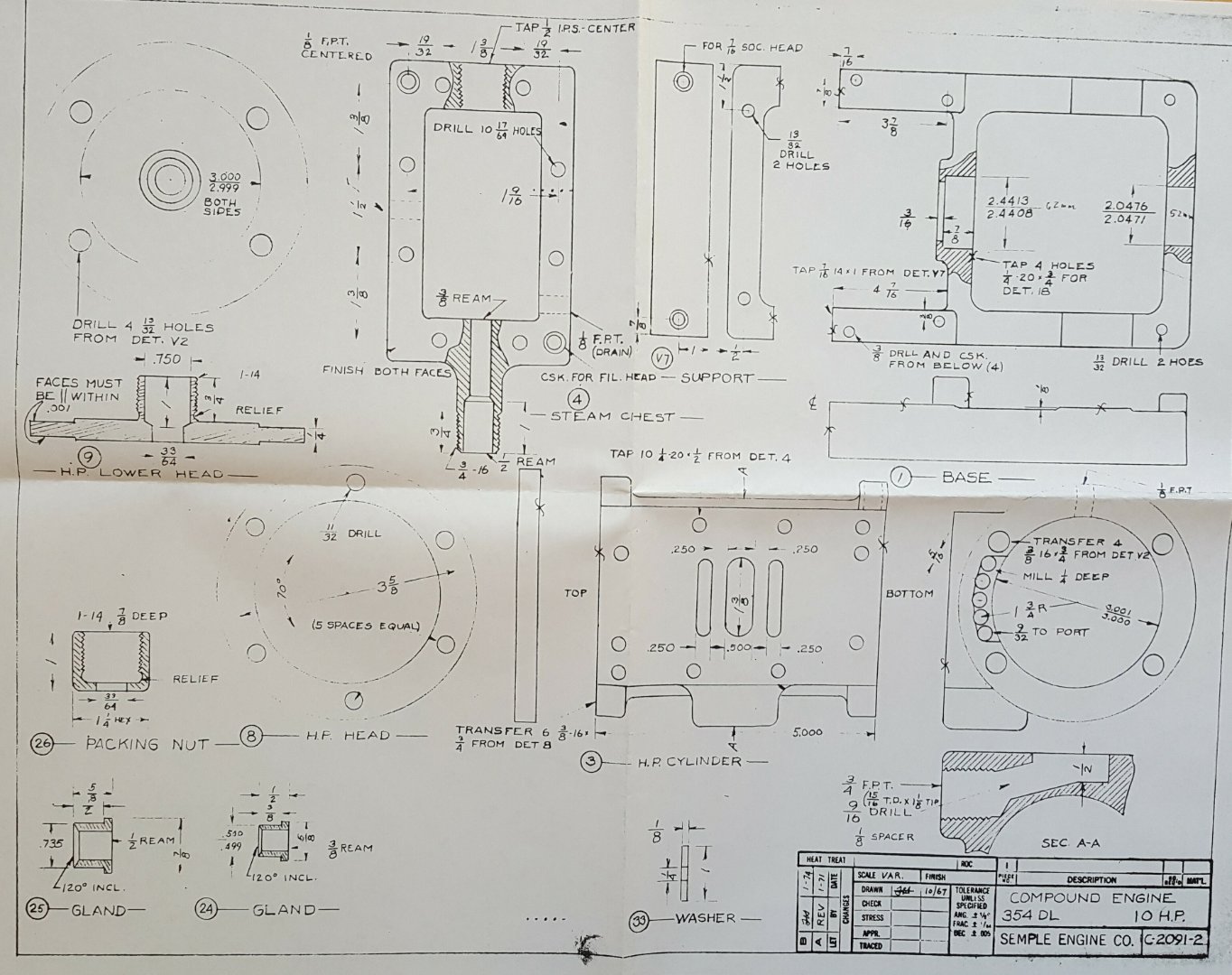

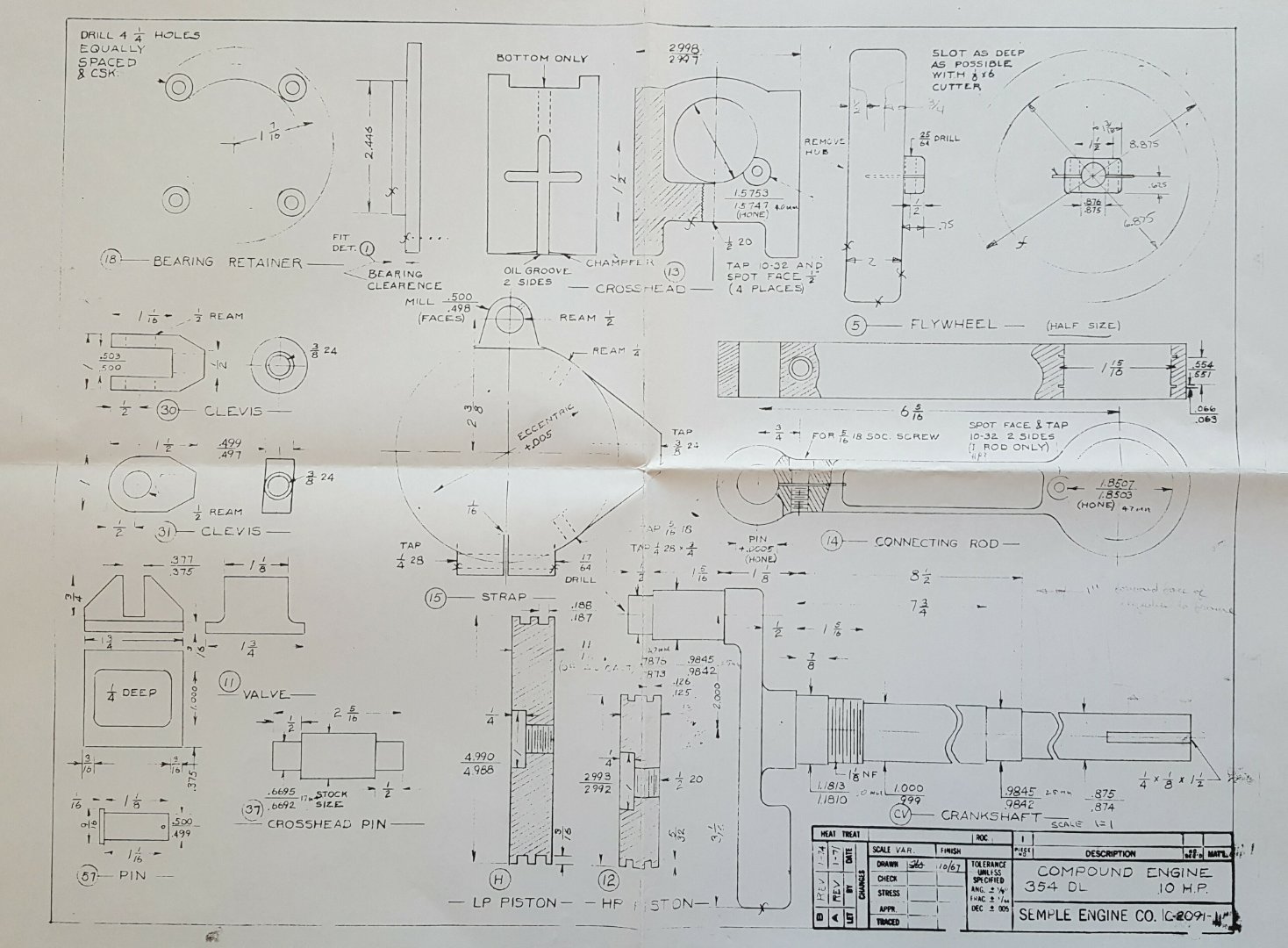

2 of 3

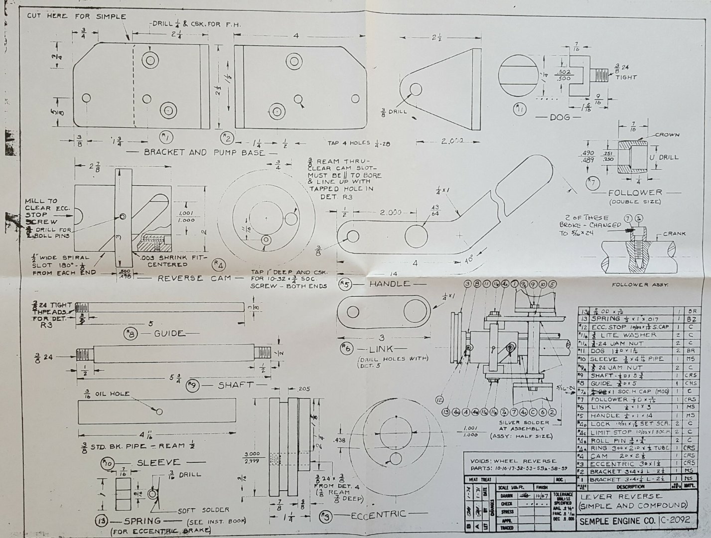

3 of 3

Thank you very much for that!
It's interesting they don't give dimensions for the overall thickness of the valve chest, valve chest face to valve stem centerline, nor the valve face to cylinder bore center. Seems a lot of "fitting" was needed in our toys because a lot of dimensions were never given...

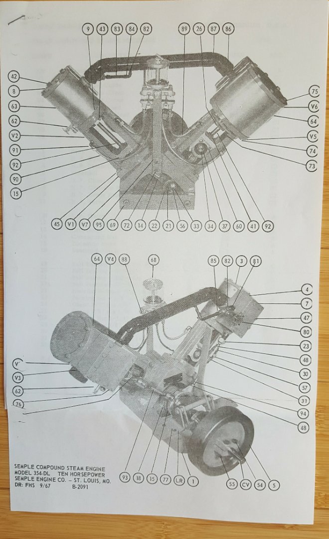

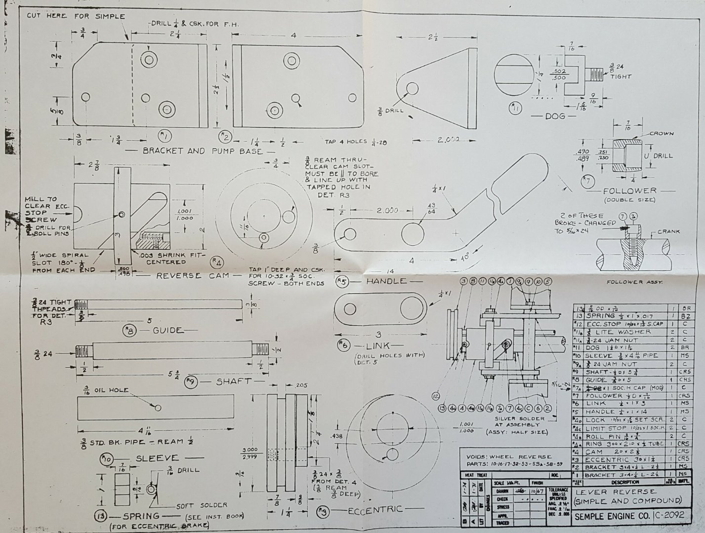

I'm going to post the 4th drawing and the instructions as well.

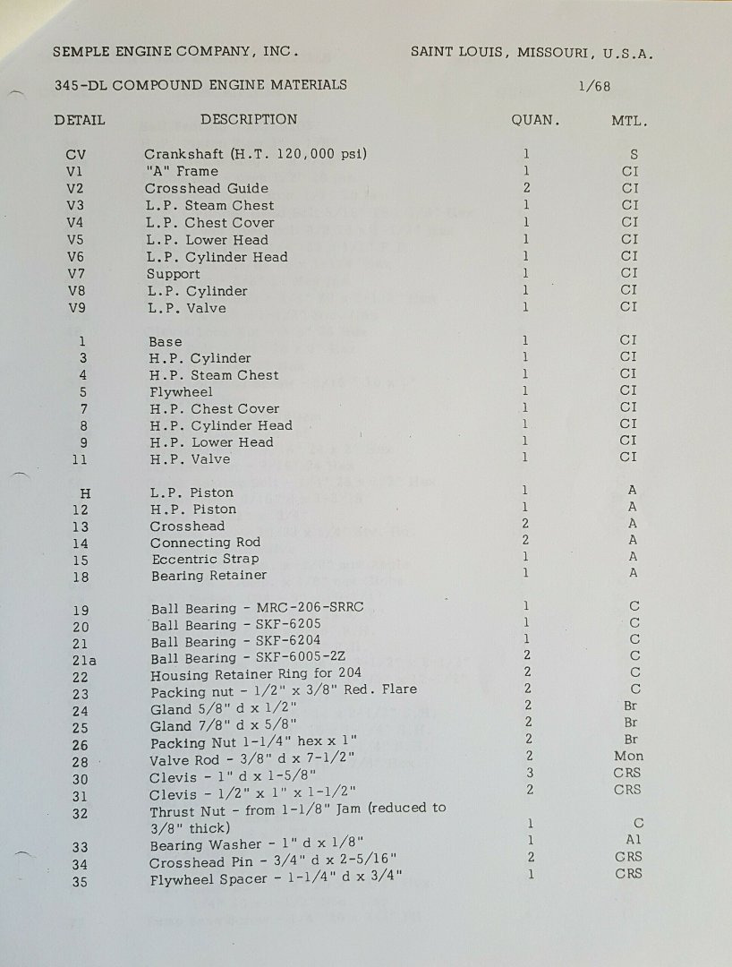

Parts list

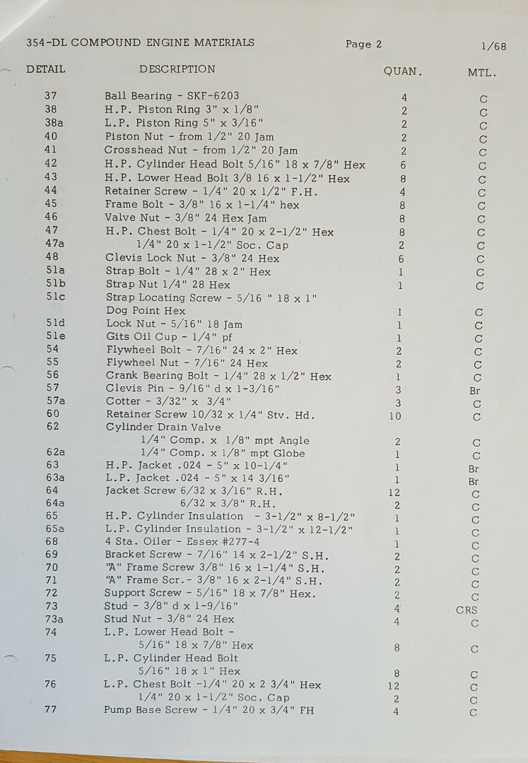

parts list 2

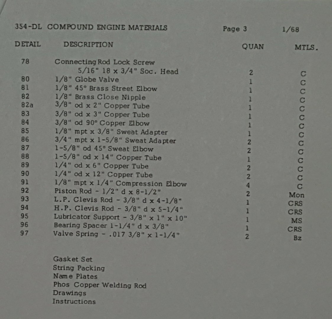

Parts list 4
