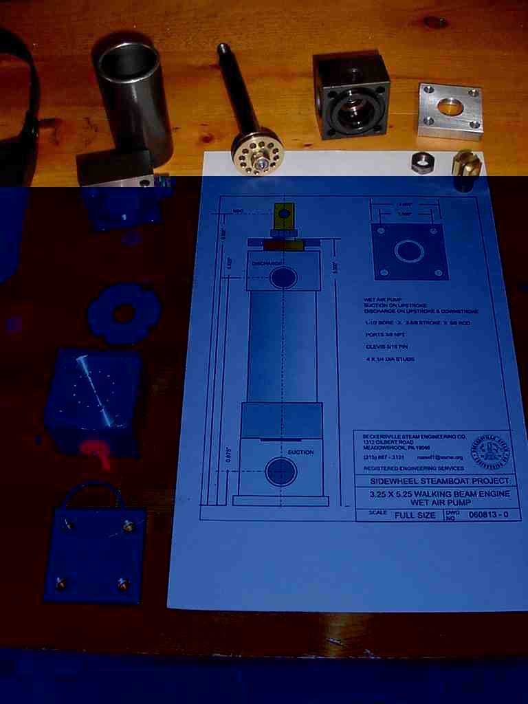

I made my wet air pump from a pneumatic cylinder, and it has been stroking away for two full seasons, running dry most of the time, as I have not yet installed my condenser. I currently use this "wet vacuum pump" as a general service water pump, filling my feedwater tank while underway, or as a bilge pump on occasion. It works OK, and will draw 22 inches vacuum if I plug off the suction connection and attach a vacuum gauge.
The check valves are made from rubber washers, and the piston is made with an O-ring cylinder seal, and several small ports that the rubber washer seats against to act as a check valve on the upstroke of the piston. You could use ordinary swing checks mounted on the cylinder's port for inlet and discharge check valves. This would work OK as long as speed is kept down to about 100 - 150 RPM. I suspect this is about the same speed that would be ideal for your Hypro pump, but I do not have the hypro pump nameplate data yet.
I have heard of steamboaters using the old style (camshaft actuated) automotive diaphragm fuel pumps for wet vacuum pumps, these are inexpensive and will work at higher speeds such as your engine RPM, 400 - 500. Worth a try.

- 1.5 x 2.625 inch wet vacuum pump for walking beam engine
- Engine WetVacuumPumpParts small.jpg (42.69 KiB) Viewed 10756 times

Thinking about your idea some more, I think an eductor fitted after the condenser may work, it would have to be big enough to handle the condensate and air, The steam consumption would probably be excessive compared with the energy used by an engine driven air pump. Also the degree of pressure reduction gained by a single stage eductor is not great, most high vacuum air ejectors are two stage.
Air pumps should be like the one above, vertical single acting so that the head of water in the upper parts help seal the pump, unlike a feed pump the clearance volumes should be kept to a minimum.
The exception to vertical is the “Dave Fogg” pump found in steamboats & modern steam launches March 1963 page 25, this has zero clearance so can be horizontal.
