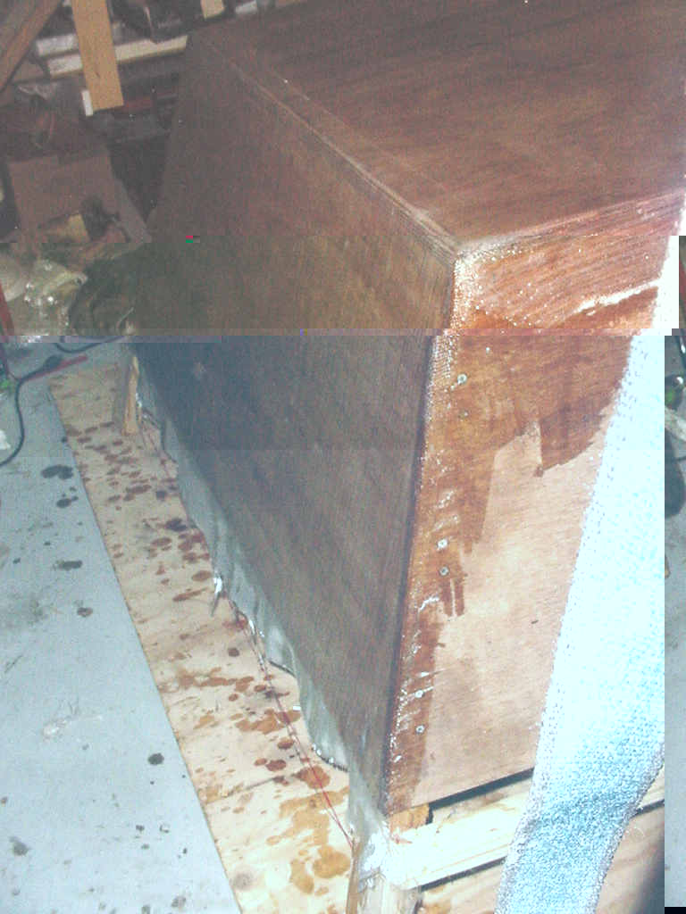

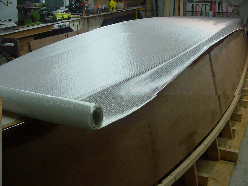

- Cloth Rolled on Bottom.jpg (65.59 KiB) Viewed 25736 times

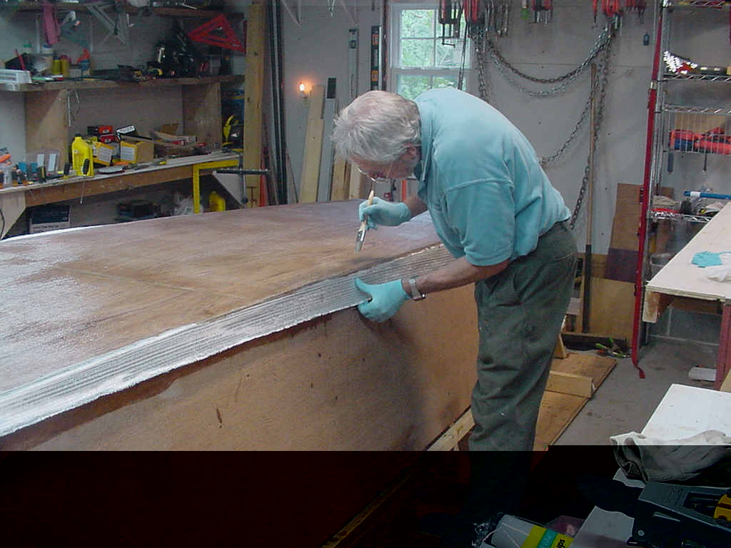

Wetting out bottom
- Wet Out Bottom 9oz Glass.jpg (80.55 KiB) Viewed 25736 times
Added 10oz cloth over the 9oz on the transom only.

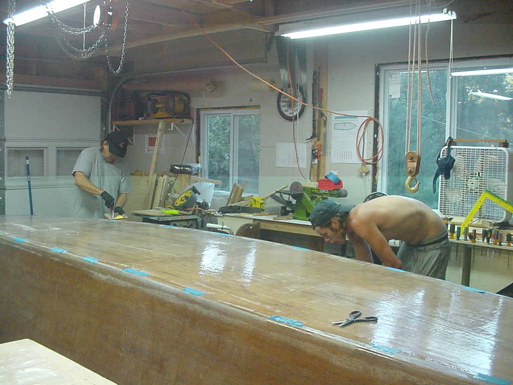

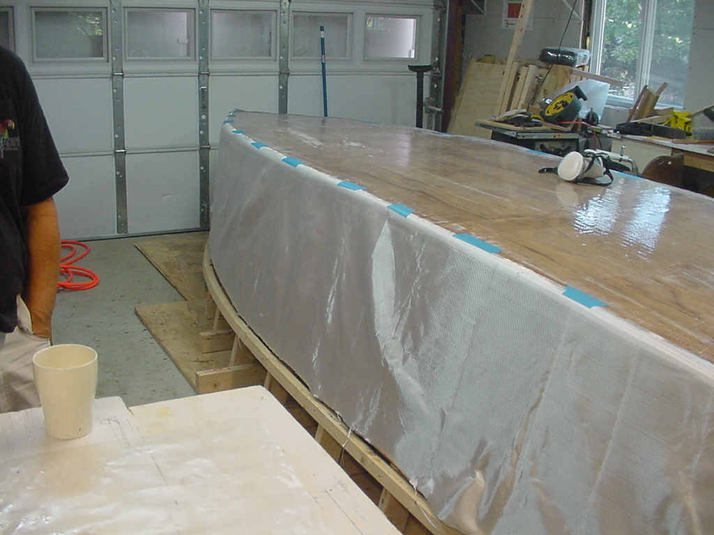

Early Sept Progress, 10 oz cloth onto sides
- Wet Out Sides.jpg (81.18 KiB) Viewed 25706 times
- 10oz Side Cloth.jpg (61.48 KiB) Viewed 25706 times

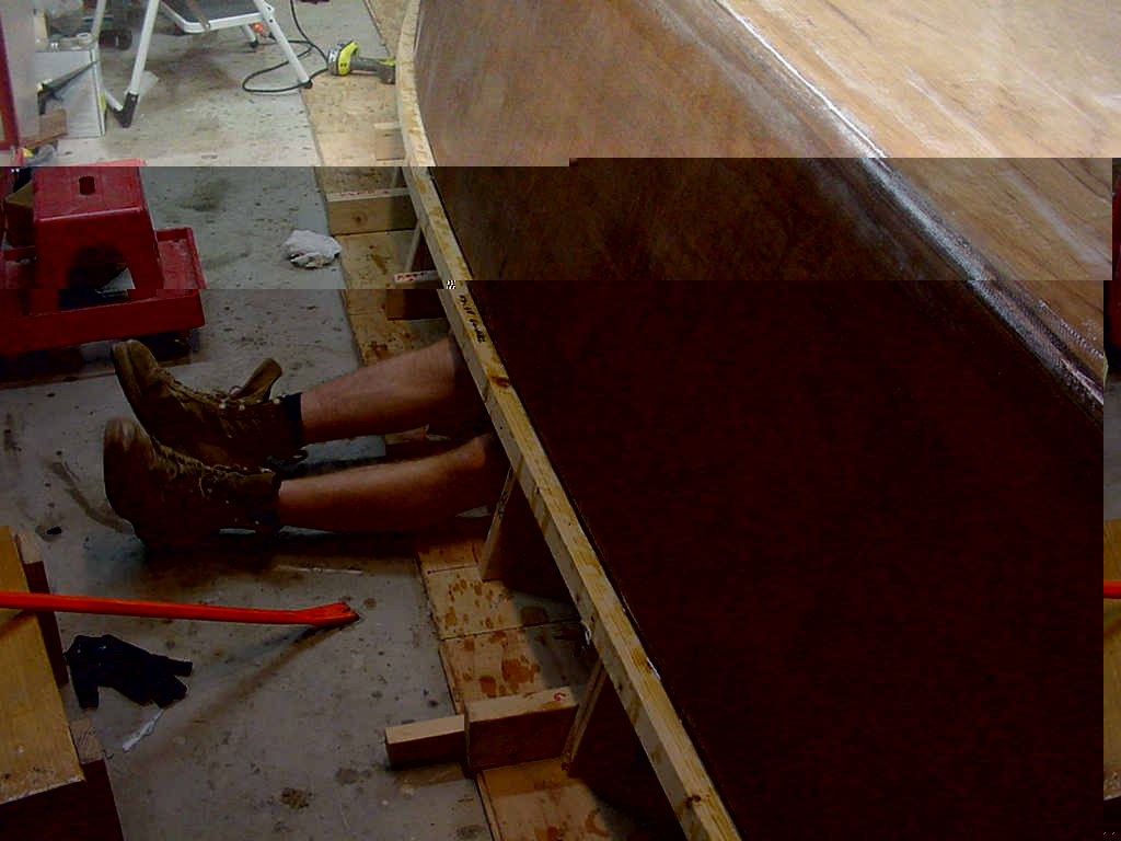

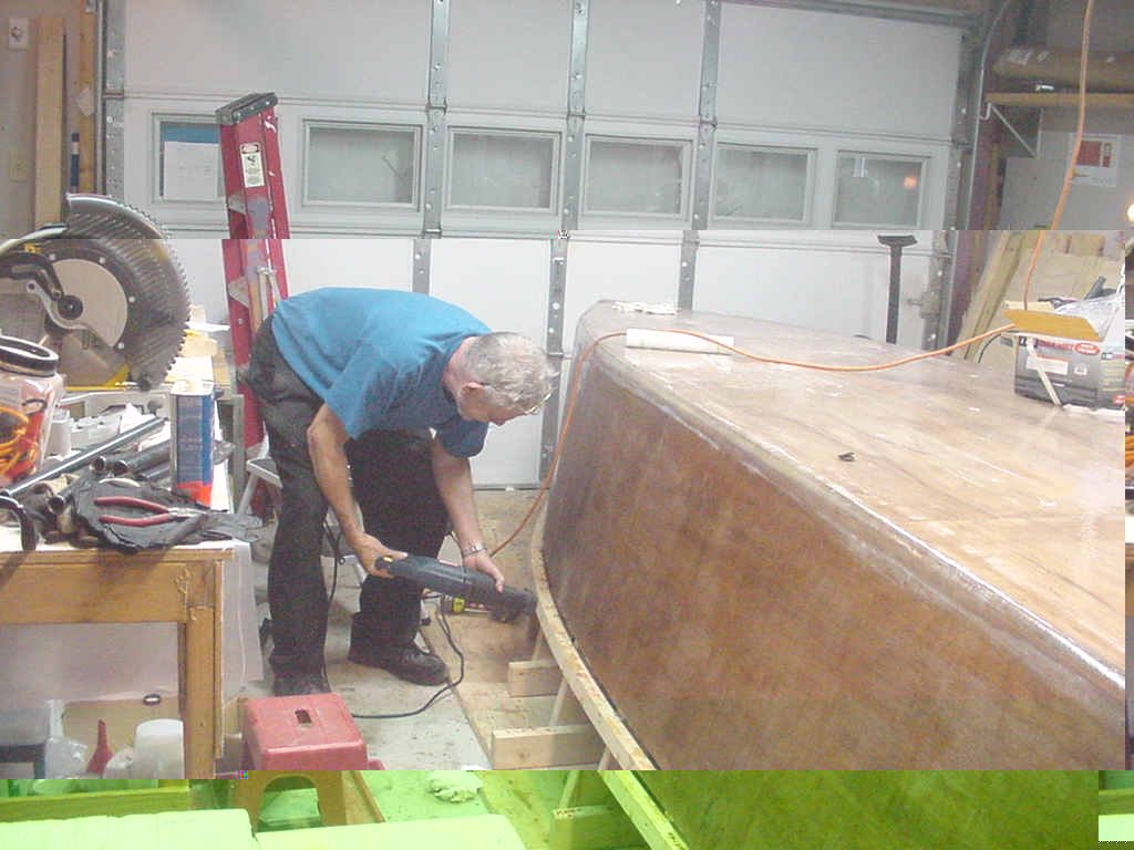

Sawing the Boat from the Building Board
- A few leftover screws.jpg (78.77 KiB) Viewed 25706 times
- Saw from Building Board.jpg (73.82 KiB) Viewed 25706 times
- Liftoff.jpg (83.51 KiB) Viewed 25706 times

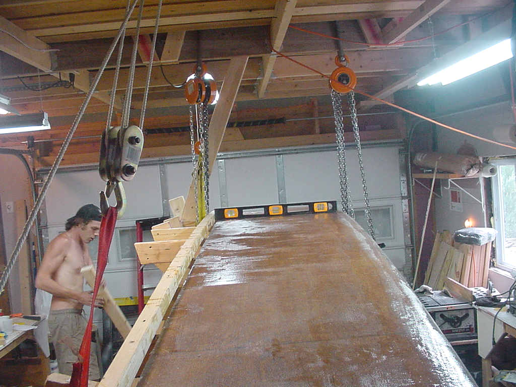

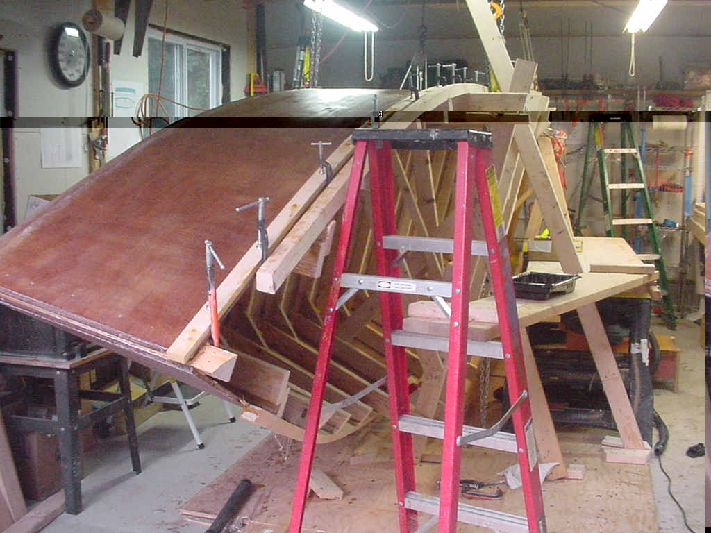

The fill coat of epoxy on the sides. We decided to turn the hull so the fill coat would be placed on horizontal surface. This minimizes to runs of epoxy, which tends toward drips and runs much more than ordinary paint.
- Positioned for Sides Fill Coat JP.jpg (91.98 KiB) Viewed 25706 times
- Starboard Fill Coat 01.jpg (88.23 KiB) Viewed 25706 times

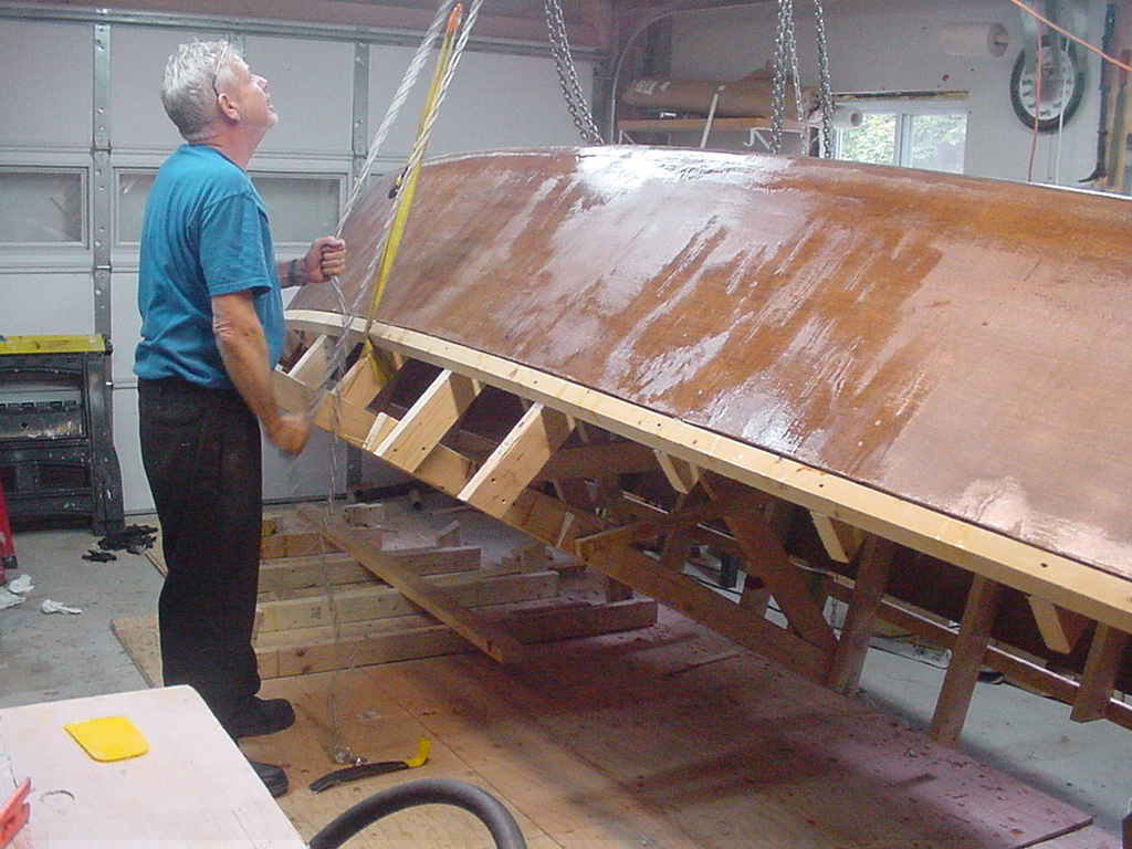

Hull exterior finally glassed and fully coated with epoxy. Keel was added (1.5 in x 3.5 in fiberglassed wood). Turned the hull over on the 19th of September, and racing to get going under steam on the last steamboat meet of the year (near me) on 10 October.
- Finally Upright.jpg (44.99 KiB) Viewed 25676 times
